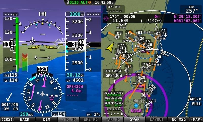

FWIW I don't know how big an RV6 panel is but I fly behind two 7" SkyView displays in my KIS4 airplane. The resolution is much more than adequate and makes possible the use of the 50/50 layout.
Here is what I posted back in March of 2013 on this setup.
Originally Posted by GalinHdz View Post
Here is how I use my dual display Skyview with transponder, EMS, ARINC-429 and ADSB.
1 - Set up the Pilot display with PFD and Map page (50/50)
2 - Set up the Co-Pilot display with PFD and EMS page (50/50)
Before engine start, press the SWAP button so the Pilot display has PFD and EMS pages (50/50) while Co-Pilot display has PFD and MAP (50/50). Now the needed information for engine start, taxi, engine run up and takeoff is displayed in front of the pilot. At this point the Pilot really needs EMS page information and doesn't really need MAP page information.
After takeoff just hit the SWAP button and now it looks like the EMS page was replaced by the MAP page for the Pilot while the MAP page was replaced with the EMS page for the Co-Pilot. Both displays keep the PFD in the same location and it looks like it never moved.
Whenever you want to look at an engine parameter in flight, just hit the SWAP button and the EMS page replaces the MAP page without affecting the PFD page. Hit the SWAP button again and the MAP page replaces the EMS page again without affecting the PFD page.
Before landing, press the SWAP button so the Pilot display has PFD and EMS pages (50/50) while Co-Pilot display has PFD and MAP (50/50). Now the needed information for landing, taxi and engine shut down is displayed in front of the pilot. At this point the Pilot doesn't really need MAP page information anymore and has good shutdown information on the EMS page.
AND it gives you a "pseudo portrait layout" in a side by side format. It works really well for me.
After 3yrs and over 300hrs of flying with this setup it makes a great combination even for actual IMC flying. YMMV
