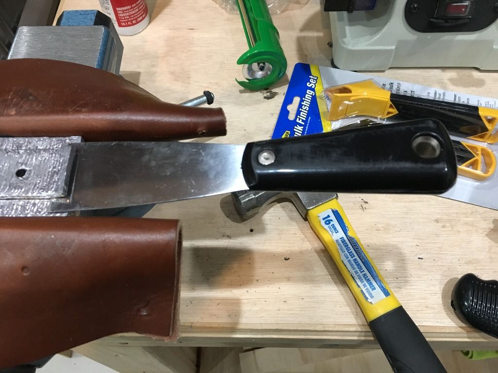

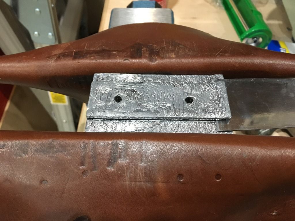

I struggled to do this without making a huge mess. Tried hacksaw, file, scoring with bandsaw, etc. etc.

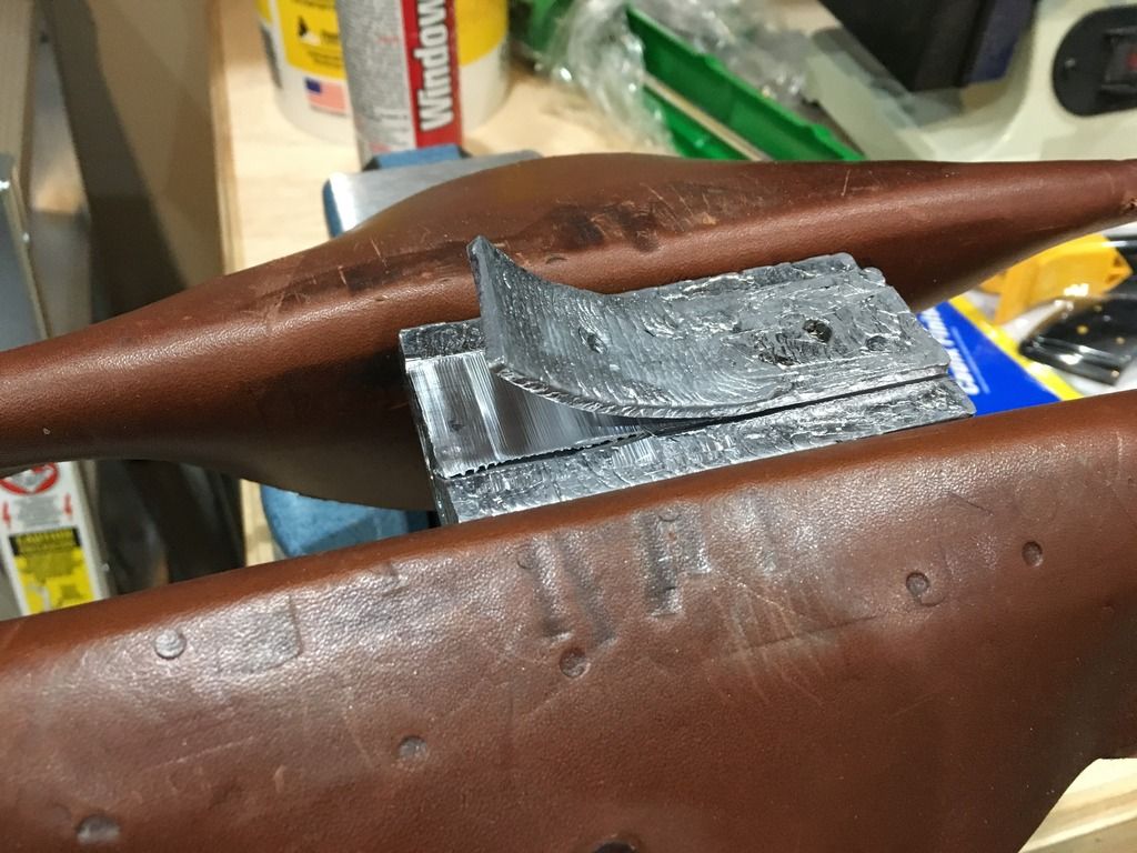

Finally got out an old (very good) putty knife and a hammer. Worked like a charm.
I scored the edges of the removal area first, then went at it from the ends.

Lead is relatively soft it can usually be cut / worked with any tool that would normally be used for wood.
A wood cutting blade in a band saw works very well on the lead, so I imagine that any small hand saw intended for wood, would work well also.
Exactly. I used my bandsaw without problem--quick and easy.

My problem with the bandsaw method was all the little pieces of lead flying everywhere. Lead is toxic if ingested or inhaled. So I wanted to do something that would be safer as well as less messy in general. And this was faster for me that the bandsaw method. I was also able to control the cut much easier than with the bandsaw. It got the lead hot and sticky!
