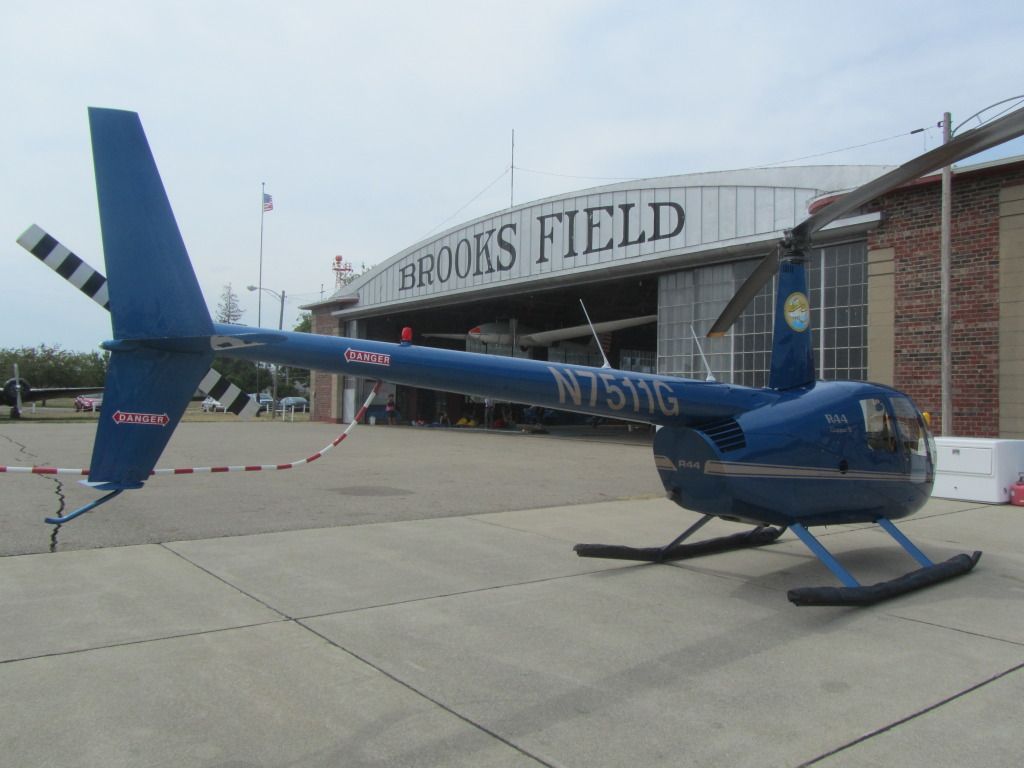

Old 11-22-2016, 01:11 PM
turbo's Avatar
turbo turbo is offline
Posts: 3,122
i believe frank robinson derated it to suit his needs of safety and high tbo limits. the engine and all rotating components run at constant rpm. engine of the r22 is at 6,525 rpms. at sea level with 20 degrees centigrade temp max mp is 22.6. add .9 increase of mp for 5 minutes on take off.
ps, added note; a temp guage is required equipment for piston robbys so mp can be determined from temp and pressure alt.

Brooks Field? Marshall, MI, RMY? Soloed at nearby BTL in 1973 while home on leave. Went back there a couple of years later just to get into the air. CFI asked if I might want to try some aerobatics. He preflighted the C150 Aerobat and we went out to do some loops and spins. After about 45 minutes of that, we were near RMY and he asked if I minded stopping in to see a couple of his friends. As we taxied in, everyone stopped to look at us. Getting out of the airplane, we saw a wide swath of oil down the side of the plane. The oil cap was found lying in the bottom of the cowling. We had about two quarts left . Kinda glad we made the stop and didn't do any more aerobatics that we did!

.....the engine and all rotating components run at constant rpm. engine of the r22 is at 6,525 rpms. at sea level with 20 degrees centigrade temp max mp is 22.6. add .9 increase of mp for 5 minutes on take off. ......... [/IMG]
Suspect a typo. Did you mean 2,525?
