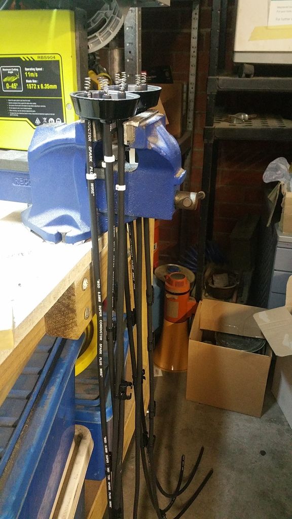

Hi Guys,

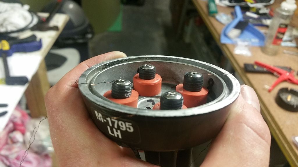

Thought I'd share some photos and progress updates as I move through this mod.
Im not going to share all the details as they can be found on the G3I website.http://www.g3ignition.com/magmod.html
Photo of G3i control box mounting, yes the zip ties will be replaced by p-clamps...

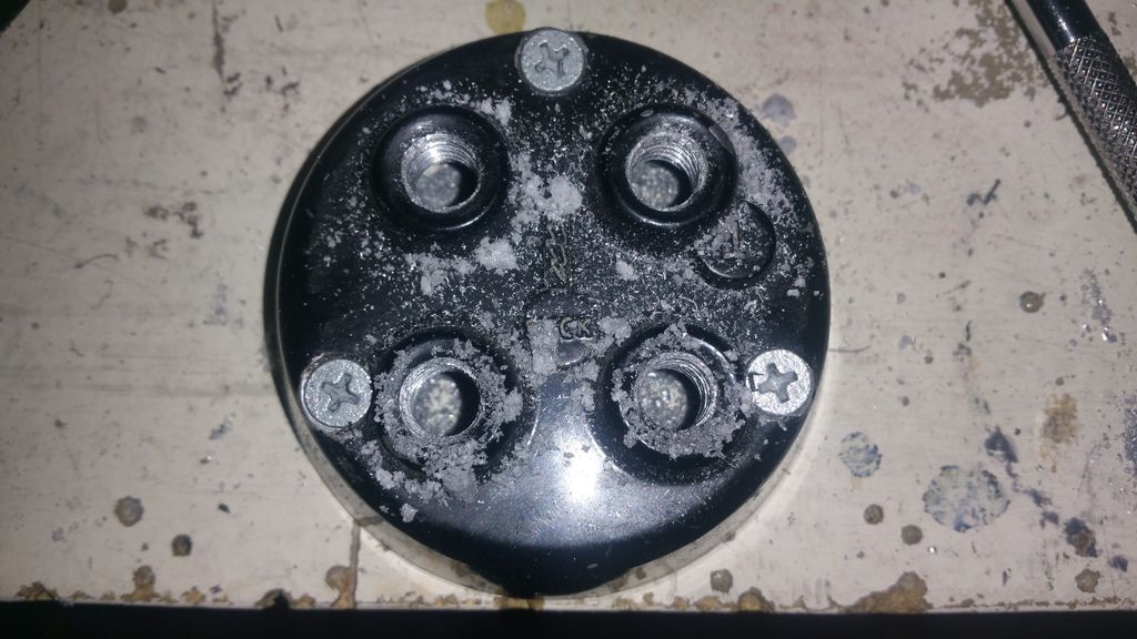

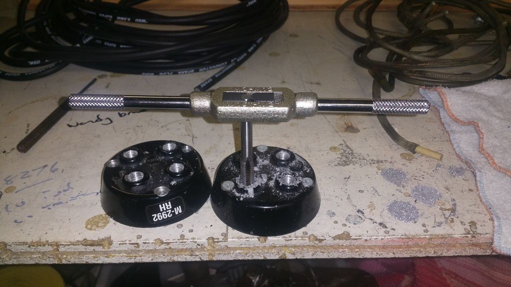

The first thing to do is remove the old ignition leads.
Then drill out the holes to size to suit tap easy on a bench drill.
I found the best way to mount the mag caps was to screw them to a bench top.
Lots of boelube, the trick to a good tap is start slowly and carefully to get the tap started and straight. Then about 1/8 to 1/4 turn and then back off 1/2 turn to break chips, rinse and repeat until your through.
I'll post further updates as i move through the process.
Regards,
Rob.

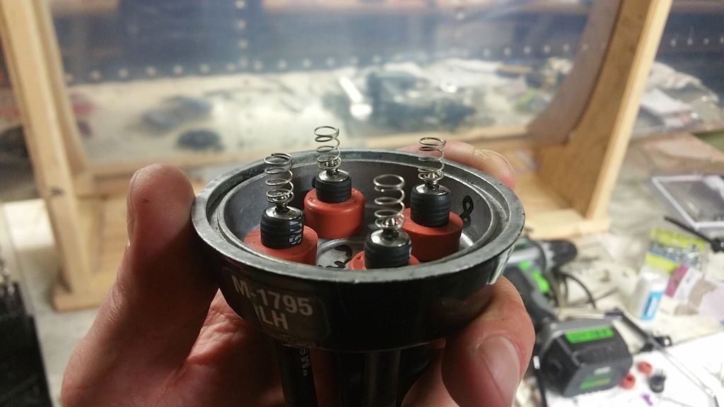

Lots o fun....

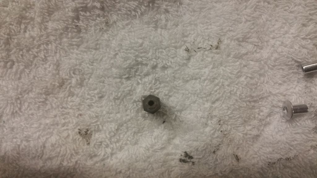

Interesting trying to find the correct rivet inserts here in OZ..... found em eventually.... tip: if you live in the US of wall building A, buy the kit from Tom at G3I..... if you live in OZ, Mexico or Canada , send me a pm and I'll flick you details of where to find everything locally....

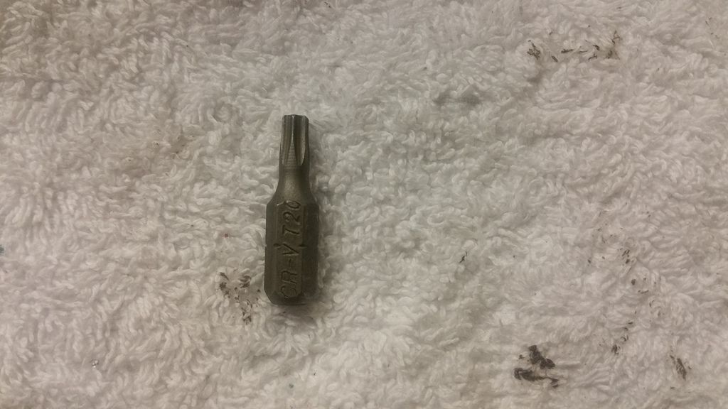

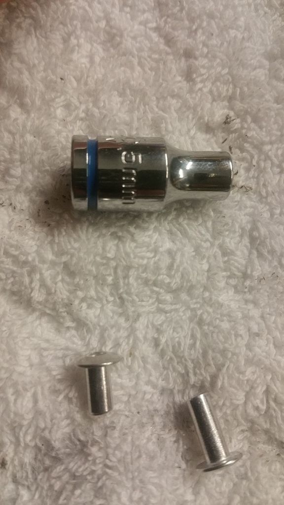

Strip back the insulators to conductor core and use a 5mm socket to seat the rivets/inserts, invaluable. Trim conductor core once they are seated.
This little hollow security driver was awesome for pushing/seating the conductor spring pins....
