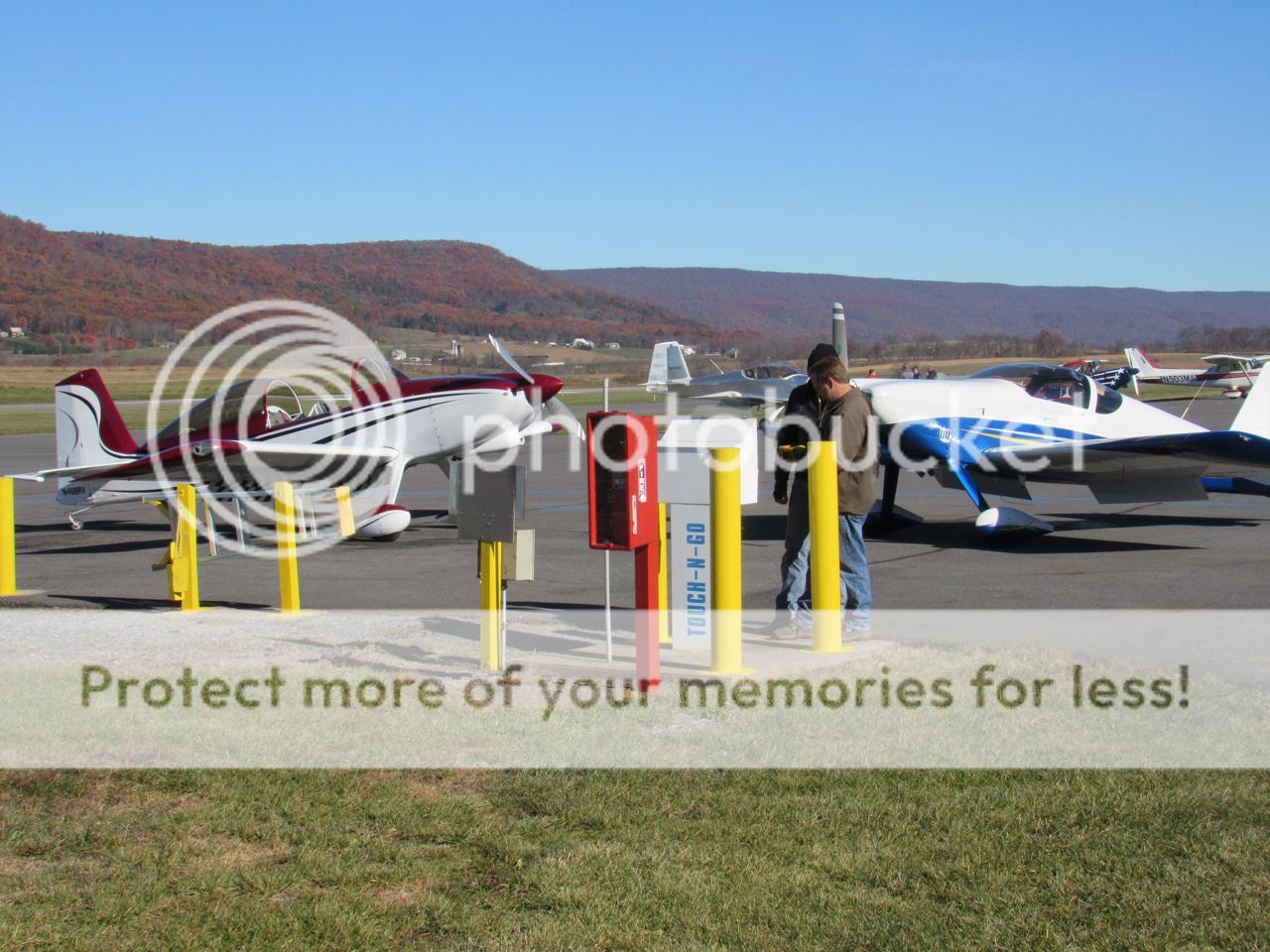

Old 11-13-2016, 03:54 PM
Posts: 8,145
I bumped into Massachussetts Gang yesterday on my way to West Virginia. Mike let me tell you keep your bird in great shape. Was nice seeing you! Alton Bay next?

Ha, thanks Vlad. I love your route to W. Virginia.
Way to warm last year for Alton Bay. Hope to see you there this year or at Rangely with CJ and the gang!
