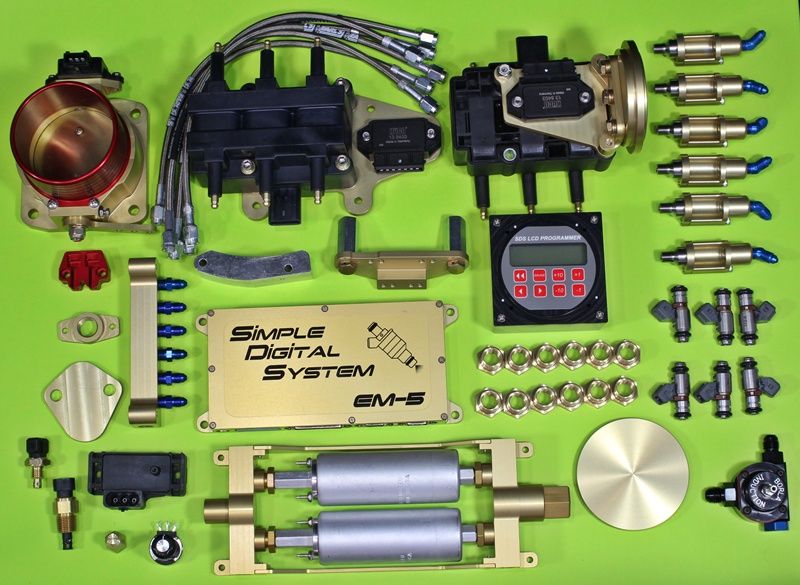

Have there been any failures of the ECU that you're aware of? And how many customers would you say choose the dual ECU vs single ECU option?

I am not aware of any ECU failures in aviation. We're closing in on an estimated 450,000 flight hours now on around 1500 aviation units. We have heard of several MAP sensor failures but these appear to mostly on third party supplied sensors of unknown quality or where the sensors were not mounted in the recommended orientation allowing condensation to settle on the sensing chip over time.
We've heard of at least one TPS failure in cruise but the pilot zeroed out the values with the programmer and continued to destination- one reason we recommend having the mixture knob and programmer installed in aircraft.
Had one forced landing on a T51 whose builder decided aluminum exhaust stacks would save some weight. These predictably melted, allowing exhaust gases to melt through the crank sensor cable. We now supply fire sleeve for that cable.
There were at least 2 failures on third party supplied coil drivers due to faulty soldering. These showed up on the ground fortunately.
There may indeed be other failures which are not reported to us. If you've had one, we'd like to know and try to learn why. There have been a number of problems caused by bad wiring practices causing phantom missing or ECU shutdowns/ reboots. ECUs do require good grounds and power to operate obviously.
I would say that single vs. dual ECU choices tend to follow budgets in most cases these days. VW guys almost never purchase dual systems, RV10 guys almost always do. Of the 1500 units flying, certainly well over 1200 of those are single ECU systems. I'd say our mix now in the last 2 years though is about 50/50 single/dual.
The ECU only draws about .1 amps and uses FET drivers (very power efficient and cool running), heat sunk to a thick billet chassis. There is no significant heat anywhere and no external cooling is required, thus there are no real reasons for a unit to ever fail. One of our bench test units had about 145,000 hours on it running 24/7 for years before it was retired for a newer model.
Unlike some competitor electronics, our controller boards are conformal coated in critical areas to better resist moisture and vibration and internal wiring is all strain relieved. I've been shocked to see how some competitors build their electronics, maybe ok sitting in your house but likely to fail bolted to a vibrating airplane over time. Our FF components are weather sealed whereas many competitor components really aren't.
We've got features that nobody else is offering at this price point like individual cylinder fuel trim, data logging and dual access programmer. Our Lycoming kits are very complete. You can see that all the aluminum bits are nicely annodized for durability and looks. Not shown in the photo below are the Tefzel wiring harnesses built to your length and termination specs.

Ross, is there any plan to verify your top mount injectors work for the ECI cylinders? I know the website says they're tested with Lycoming only. If it was a known working bolt in config for an ECI 320, I'd start planning how to make the necessary fuel and electrical mods to support an install.
The info on single/dual ECU is insightful; is it a straightforward process to change the single to dual later on if desired, say for an IFR upgrade? Or simply better to go dual from the start.

I'm in the same boat, at least for the RV-7A project I'm about to buy. The engine is a Titan ECI O-360 which I assume has ECI cylinders. I saw the plugged injector ports on the heads and I expect you could use a Bendix-type FI system.
I would also like to know if the SDS thread in injectors would work on this engine.
The RV-10 I'm building has a Lycoming engine, not a clone. I would like to use the same system on both airplanes.
A customer with ECI cylinders will be receiving his kit next week and verify the screw-in injectors fit these ok. Detailed photos make it look like they will fit but only trying them will confirm.
I will be out at an engine shop in the next 10 days regarding some other matters but I'll try to test fit the injectors on all brands of cylinders I can find in their shop while I'm there. Will report my finding here.
It's not so easy to change from a single to dual ECU after installation but doable. There is a lot of extra wiring, sensors and switchgear to install and the programmer would need to be changed for the dual access type. The Hall sensor mount accepts both single and dual type sensors though so that can remain as is.
