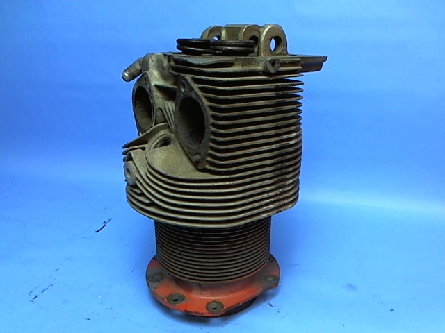

Engine is an O-235. On the backside, of the cylinder heads themselves, on the bottom, there are +/- 3/8" diameter holes. What are these and what is their function?

Location: fort myers fl
Posts: 945
Thermocouple wells for Cht probes
Bob burns

I'm chasing down an oil leak and it almost looks like it's coming from one of these holes.
Is there any logical reason for this, short of a crack in the casing?

It's the hole at the base of the cylinder head, next to where it attaches to the cylinder barrel.

A photo might help.

Smile Some pics...
Some random pics off the internet...
The holes outside of the rocker cover are for the side (fore and aft) baffles
The hole under the spark plug hole is a well for the CHT probe
The hole just under the rocker shaft hole is for the baffles that go across the engine compartment

Great pics. The hole is the cht probe hole.
