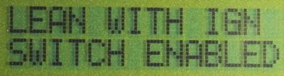

We've just finished testing V29 software and this will be shipping in new ECUs starting next week.
Highlights of improvements and new features over V26-V28:
1. New LOP function tied to ignition advance switch. This can be configured to either just advance timing a programmable amount at the flick of a switch after manually leaning or simultaneously advancing timing and leaning a programmable percentage. There is a hard MAP limit imposed to negate both functions above about 75% power for some protection against forgetting the switch positions near WOT and low altitudes.
Leaning with ignition advance

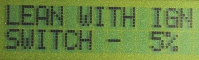

Window to set the percentage to lean- up to 65%
