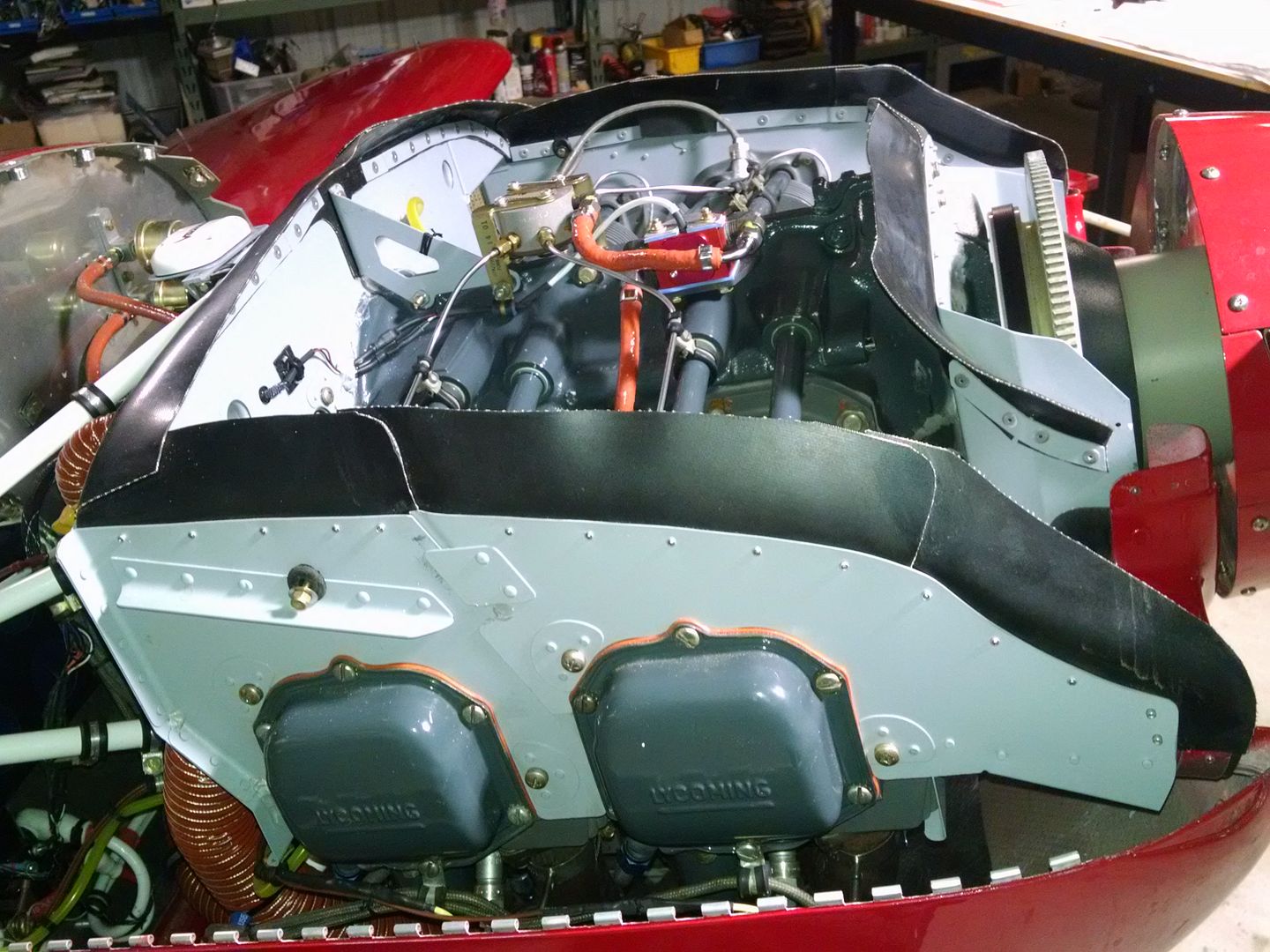

I've used both and I could not tell any difference. Just a note to be aware- the stuff I have here is the non reinforced "pure silicone" material. The other stuff has fabric imbedded. I've not tried the "tuck and stretch" method used here with the reinforced material, but I suspect it will be a bit less compliant.

After posting pictures of my seals with a couple of "puckers" Dan admonished me and pointed out those are also know as air leaks. Back to the drawing board...now they fit nice. The reinforcement strips limits the use of silicone between the rivets.
