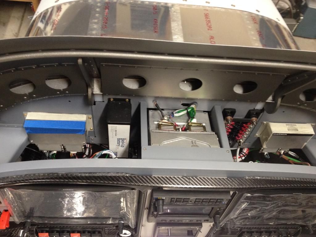

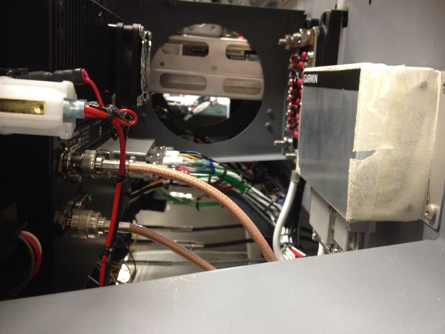

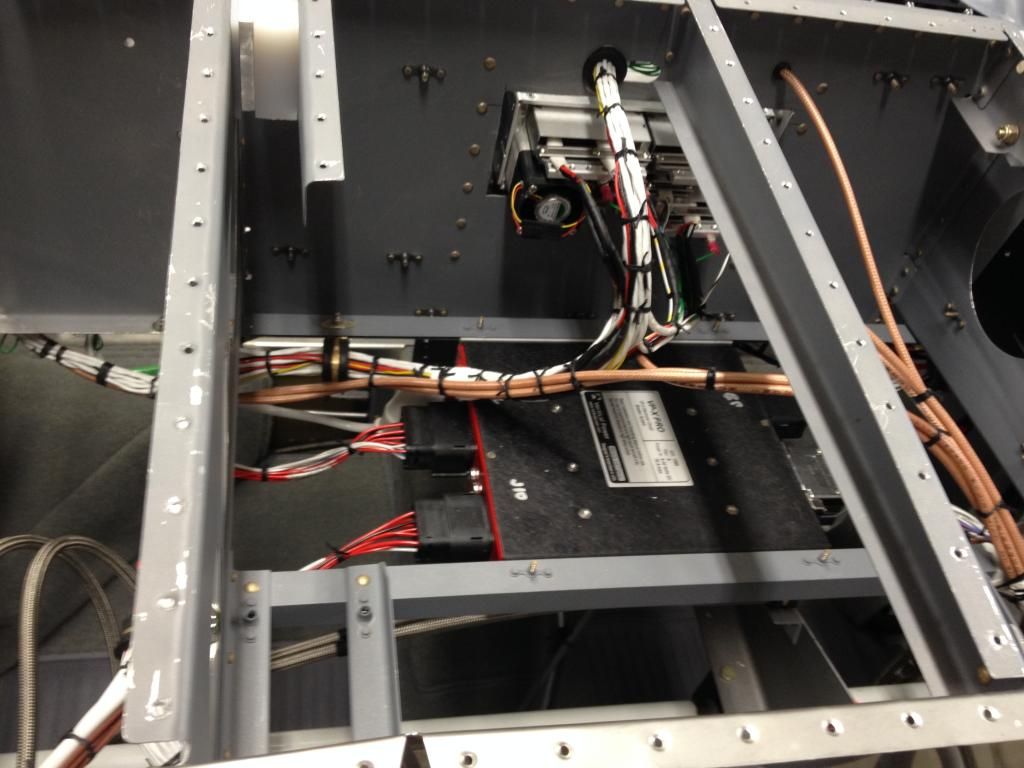

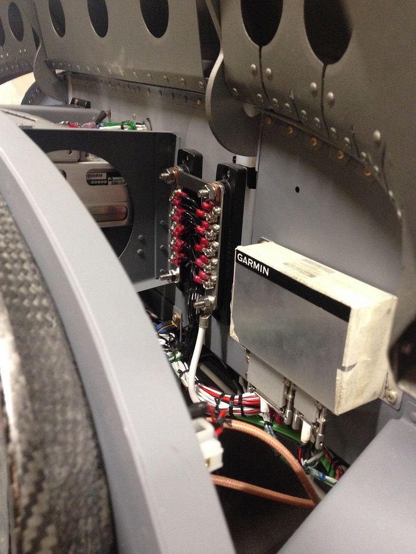

Almost time for me to start cutting holes and running wire for my avionics. I've got one of the nice Symmetrical Carbon Panels from Geoff at Aerosport. I'm installing (2) 10" G3X Touchscreens. Anyone have pics of the sub panel ribs and mounting for such a setup? Any other pics of your other components in the sub panel? I'm also installing a Vertical Power Pro. Thanks!

Top Down...
Right Side...
Right Side Again..
Left side...
Between sub-panel and firewall, looking aft...

Andy...thanks so much for the pics. Excellent!
