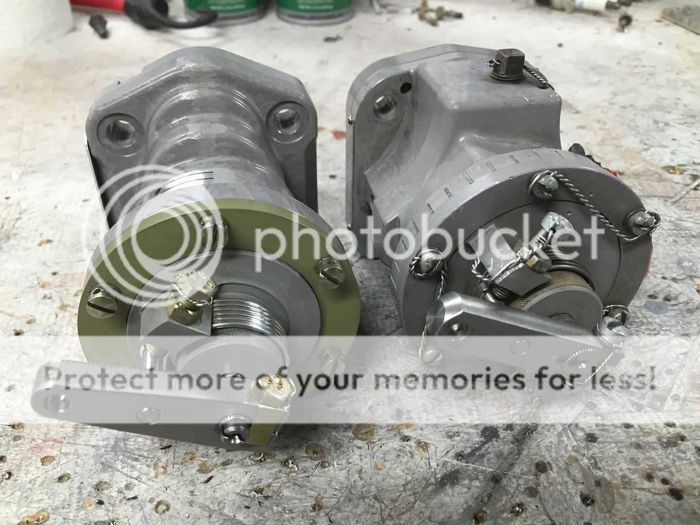

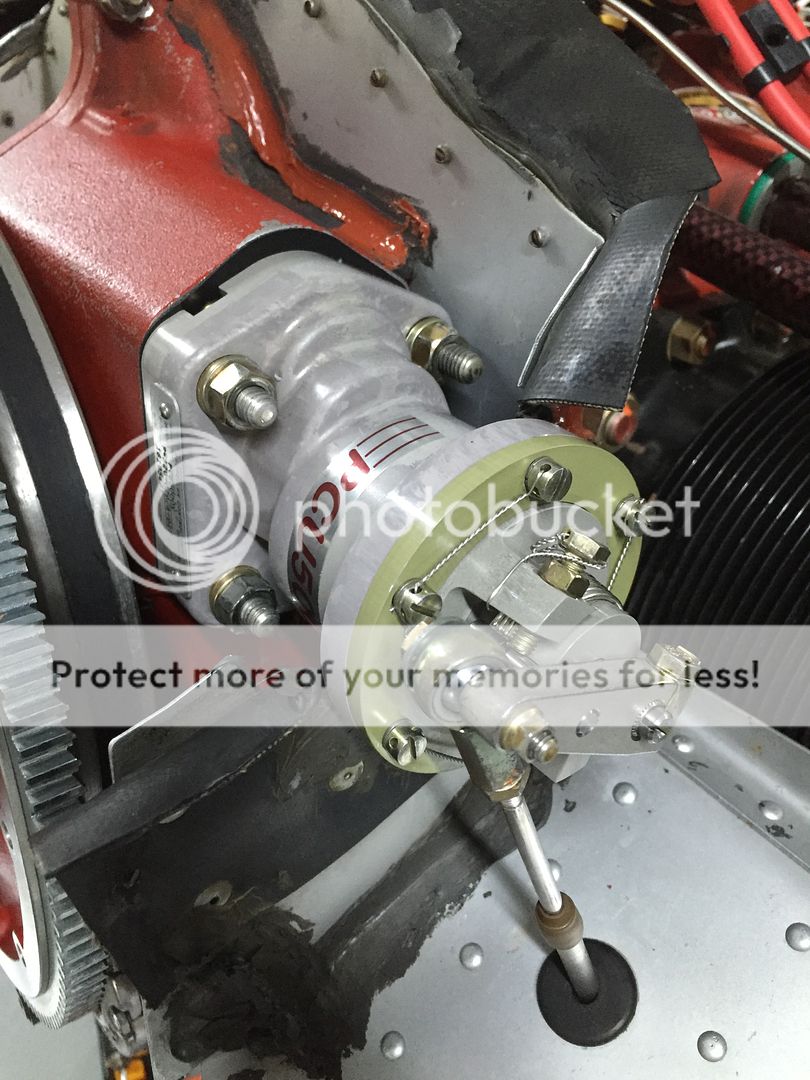

Old 08-26-2016, 12:01 PM
aturner's Avatar
aturner aturner is offline
Posts: 549
It appears (someone correct me if I am wrong) that the PCU-5000 is very similar to the MT 860 in external dimensions, whereas the Hartzell is larger, and may require some reworking of the cowling and baffling.

Old 08-26-2016, 12:29 PM
woxofswa woxofswa is offline
Join Date: Sep 2007
Location: Mesa Arizona
Posts: 608
That's true but very minor. Basically it's the opening in the Captains side front eyebrow cavity on the bottom side of the top cowl. We did the rough modifications in the field in about 3 mins with a Leatherman tool, which will be easy to final finish when the time comes.

Old 08-26-2016, 12:33 PM
Auburntsts's Avatar
Location: Tampa, FL
Posts: 2,861

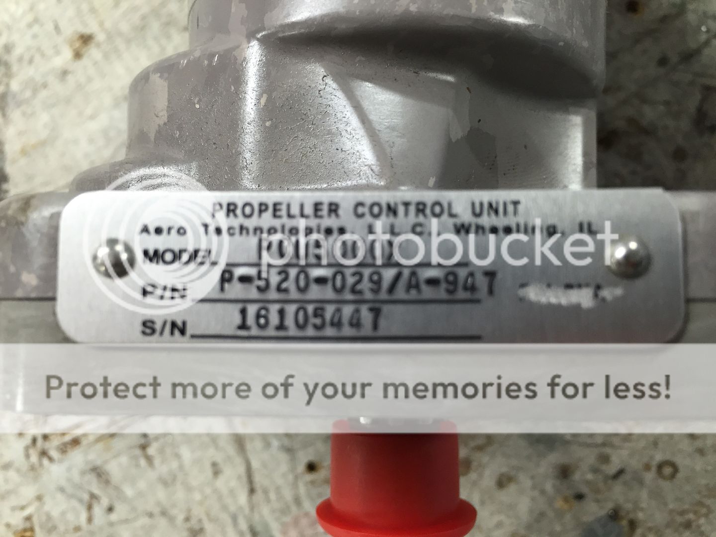

I don't have one yet. I just used a donor to get home.
I will say however that the MT always chased rpm +/- 10 or 15, especially the first part of a flight and I just wrote it off as indication artifact error. The donor Hartzell stayed glued to wherever you set it and never required any adjustment.

Old 08-26-2016, 12:51 PM
rleffler's Avatar
rleffler rleffler is offline
Join Date: Jun 2006
Location: Delaware, OH (KDLZ)
Posts: 4,194
Originally Posted by Auburntsts View Post
Myron, which model did you get -- S-1-26?
I got a S-1-32 in my FWF kit
Bob Leffler
N410BL - RV10 Flying
http://mykitlog.com/rleffler
Auburntsts's Avatar
Location: Tampa, FL
Posts: 2,861
I asked because I've been trying to decrypt the Hartzell application guide to figure out the exact model for a narrow deck 540. Right now I think it's S-1-26 for the narrow deck and S-1-32 for the wide deck.
I guess I'll shoot off an e-mail to Hartzell and see if they can confirm.
