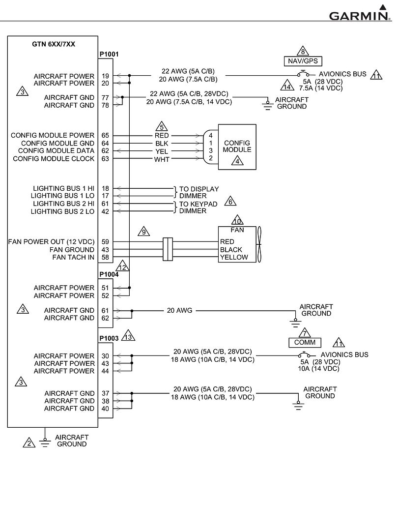

I'm planning on installing a GTN650 in a panel updgrade for N323TP. I need to pre-position and label the required breakers in the new panel.
I'm not sure if the unit requires 2 or three breakers and the amperage rating of each. Also, how should they be labeled?
Hoping to silkscreen the labels and also have the proper hardware in place before the radio is installed.

With a 14vdc power system, the GTN-650 install manual calls for a 7.5 amp NAV breaker and a 10 amp COM breaker.

Carl is correct, and from the 650 install manual label the 10amp breaker Comm and the 7.5 nav/gps

The Nav/GPS breaker powers two pins each on the Nav (P1004 pins 51 and 52) and GPS (P1001 pins 19 and 20) connector with a 7.5Amp circuit. The Com breaker powers 2 pins on the Com (P1003 pins 43 and44) connector with a 10Amp circuit.
Is there a main breaker as noted in by earlier poster?

No, just 2 breakers.

Perhaps I was working from an old installation manual, but 1) table 5.2.1 on page 5-2 (2012 manual) shows clearly power inputs for main, nav and com. And 2) this is the way Stein wired my harness and how I wired the radio. Since no smoke has escaped and it works fine, I'm assuming I did something right.
If you don't have the installation manual, and for some strange reason Garmin doesn't make it available online, here's the link to my copy from 2012:
http://www.marksrv8.com/docs/GTN650.pdf

Don't forget the NAV receiver. It needs power too. If it's a 650, it has the VOR receiver.
EDIT: I see you're ganging up the power inputs for the main/gps and the nav under one input, and the com under the other. I chose to use three inputs

Figure E-4 from Recision 4 of the installation manual is below. I forgot pin 30 as a third power pin on the COM connector.
