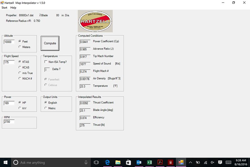

[quote=Walt;1103643]Adjusting the low pitch stop on your prop will prevent an overspeed QUOTE]
Are you sure about this? With the low pitch stops set per manufacture for proper take-off RPM at rotation speed and then flying at over 175 knots TAS in a less dense air mass I don't see how the low speed stop can prevent overspeed. There is quite a bit of blade pitch angle difference.
Weasel
RV-4 715hr Sold

08-16-2016, 08:16 AM
Join Date: Aug 2005
Location: Dallas/Ft Worth, TX
Posts: 5,668
[quote=Weasel;1103660]
Hmmm, you have a good point, no I'm not sure and will need to look into this more now.
