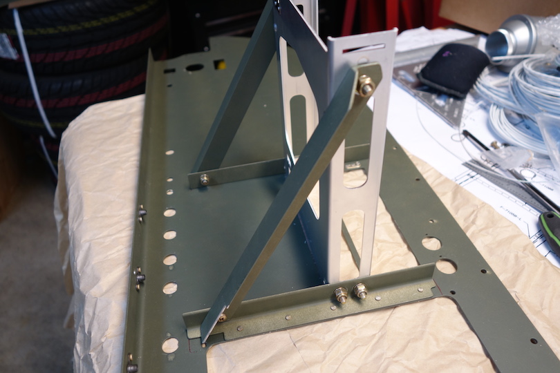

I'm about to begin the install of the GRT 200 in a slider panel RV 9. Does anyone have photos of their mounting in a slider panel who would be happy to share them?
Bit lost as to the actual mounting of the tray, appreciate all will be different but this is new to me.

I have a little bit about it and some pictures in my build log at https://flrv9.wordpress.com/2014/09/...-and-fwf-work/
There are some blogs out there with far more details than mine I am sure. Essentially the process involves getting the rack flush with the front panel and match drilling it to some angle attached to the rear of the panel. From there the unit itself just slides in and is tightened into place with an allen wrench.

Here's a log entry with a bunch of photos on how I did mine: http://www.prettybits.com/?sectionID...51&projectID=1
Final bracket:
