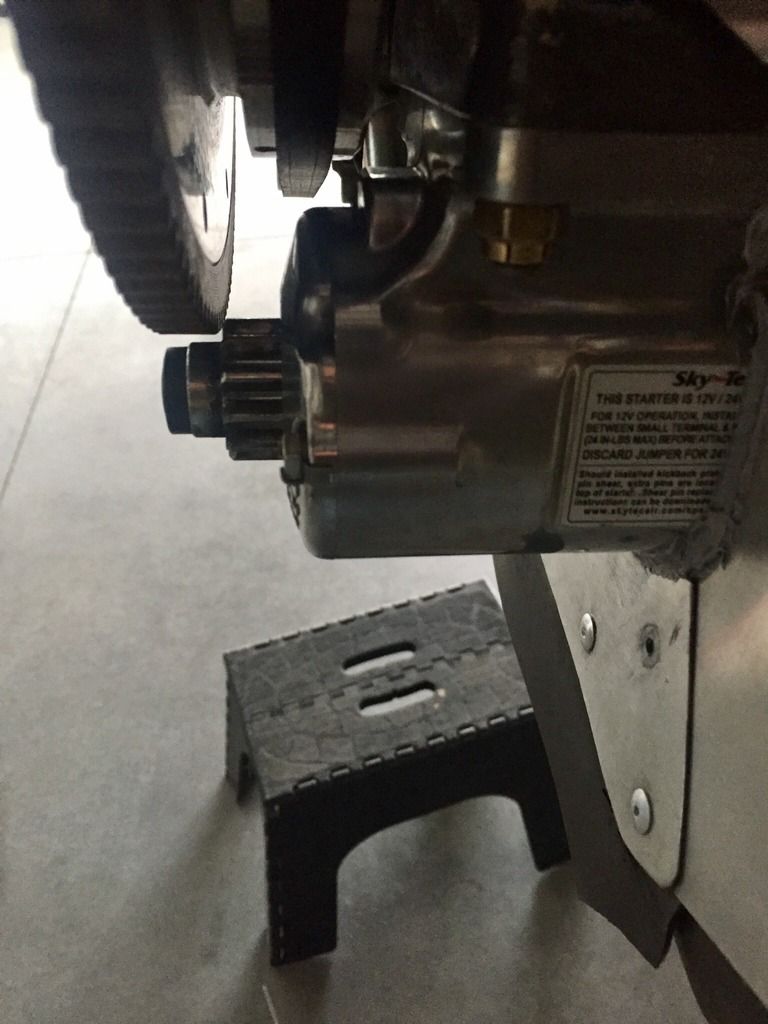

Default Skytec design change
I have had to send my Skytec 149 in for repair for loose threads and /or coming apart 3 times. I had heard they had effected a fix for this and today I noticed for the first time that the new unit they sent me last has a design change. The old design used long screws that passed through 3 sections of the starter. My new one uses short screws that thread into the center section to attach the end cap to the center section, and I assume 2 more short screws threaded in from the other end.
I hope it works, so far so good at 35 hrs.
Tim Andres
Tim Andres
Tim, could you post a picture when able? Thanks . . .
Got it, That helps.
Bill

Posts: 633
It's not a great pic or I would have posted it yesterday. You can see the threaded screw hole boss cast in the case near the drive gear. The old one had very long screws that passed all the way through the center casting into the next section. I think it was the length of these screws that allowed the torque from the starter to "rack" the assembly and eventually loosen the screws, but I'm no engineer. This definently a change from the 2 previous starters.
Tim Andres
Note, this is on a pusher and yes I see there is a rivet missing.
