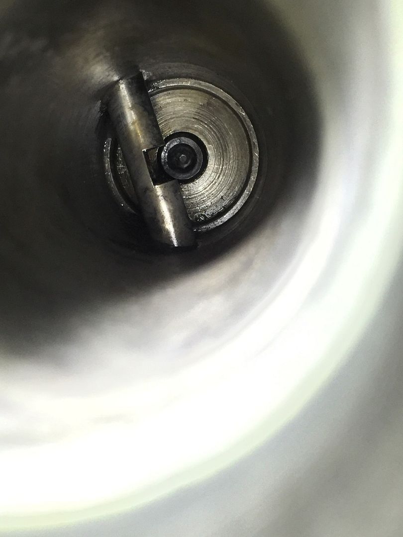

Do a search using Lycoming crankshaft-you will find some pictures that show the front main bearing area, which is quite long. The rear plug is near the rear of the front main bearing area.
A search using Lycoming crankshaft plug will produce some pictures looking straight down the bore of the crank with the front plug removed.
If your engine was configured for fixed pitch there are two possibilities: the aft plug may be absent or the aft plug may have a hole in it to allow passage of oil in the fixed pitch configuration.
An intact aft plug must be installed for constant speed configuration. The aft plug is behind the small oil cross tube and you will need to have someone with good Lycoming skills install the new tube. An engine shop would be the best option.

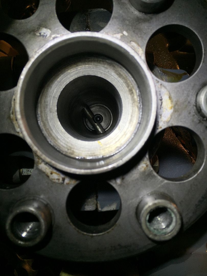

Review Lycoming Service Instruction 1435 for advice:
http://www.lycoming.com/Portals/0/te...rsa;%20....pdf
Not sure if it helps, but I have a few pics of my HIO-360-A1F6D variant. Here's a shot with the front plug out, it's my understanding I have the not so common Allen head plug in my crank that I remove for fixed pitch.
RV 7 400 hours and counting
19 donation done

Thanks crabandy for the pictures. I pulled out the plug today and it appears that mine is good to go for the constant speed prop. The rear plug is solid and there are two tubes like the one in the picture above.
Thanks everyone for the help!
