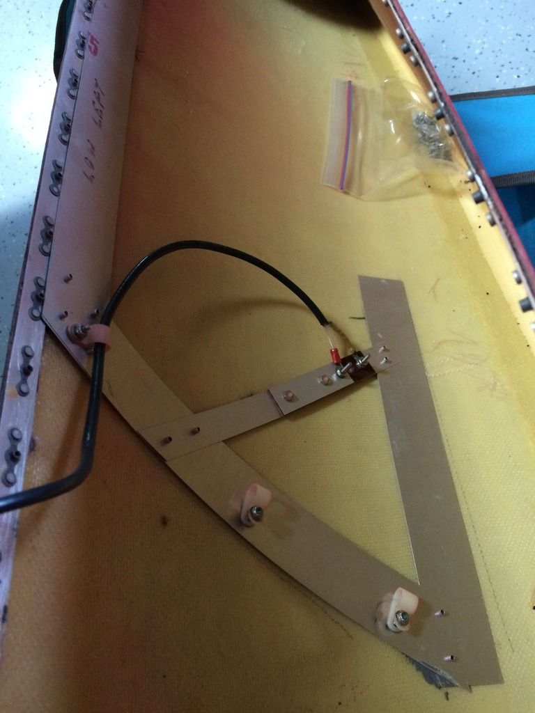

I have a recent panel modification to all glass AFS. No GPS Navigator. Thus I am depending on ILS for IFR approaches. I am getting marginal reception of localizer/glide slope and would not be comfortable flying IMC with this level of reception. I have an Archer antenna installed in the left wingtip. Purchased the airplane flying. Here is a pic of the Archer antenna. Is there anything obvious that might be causing the poor reception?

It needs to be flipped, left right!
The side which is shown right needs to be electrically attached to the metal wing and end rib. One way would be to remove the nutplates, slide the now right, soon left, arm under the nutplates and re-rivet. Or just rivet a few aluminum straps to the antenna and the metal nutplate backing strip. Make sure there's no paint under the attach screws between the wing and the nutplates.
The arm shown left, should be right, will be outboard. Use some epoxy or fiberglass to keep it from floping around.
PS Hard to tell in the photo, but the piece at the bottom should, in flight, be reasonably horizontal.
PPS Amazing it works at all, as it is!

Do you have the installation instructions? If so, those would be a great place to start. In addition to everything Bob said above, I recall the instructions wanted wires to not be perpendicular to any portion of the antenna.

Yep. Agree with Bob. Needs to be flipped and grounded through the nut plates to the wing. I have the same antenna in my Rocket and reception is rock solid.

So I need to drill holes in the short arm on the right and sandwich this part under the nut plates? The point of the antenna will now face to the rear?

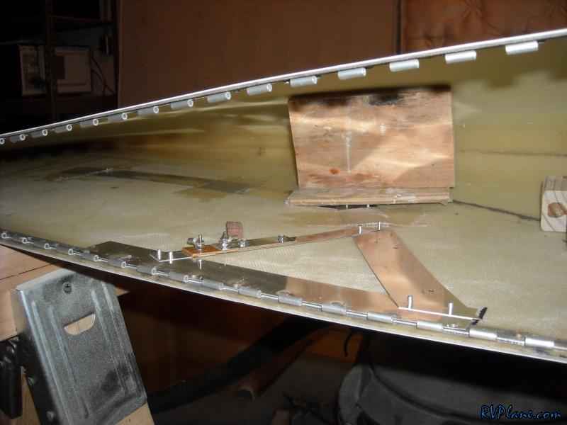

Jim,
This is how my Archer NAV antenna installation looks -
Mike Bullock

Looks like that antenna belongs in the right wingtip. It can come right or left. And there is a Nav and a Com version that look almost identical.
