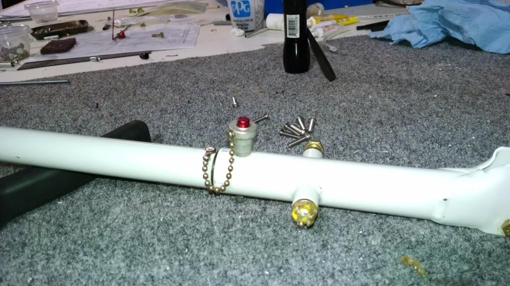

I am changing the copilot stick from permanent fix to easily removable by changing the nut and bolt for what??
Any ideas ??

Here's what I did:
http://www.vansairforce.com/communit...9&postcount=27

I just drilled mine for a bolt but have been thinking about some sort of quick release pin. McMaster have them and they are about $20. There are 3/16" versions so it should be interchangeable with an AN3 bolt. The only thing was the bolt wasn't that easy to install so it may not be that easy to insert.

Use one of these: Vailabele from Grainger. You have to buy 5. Sell the 3 or 4 you don't need to others here for $5 or so. Everyone gets a good deal.

I ordered 4 if the "c" clips. I have 3 spare if anyone needs one.

Default Locking push pin

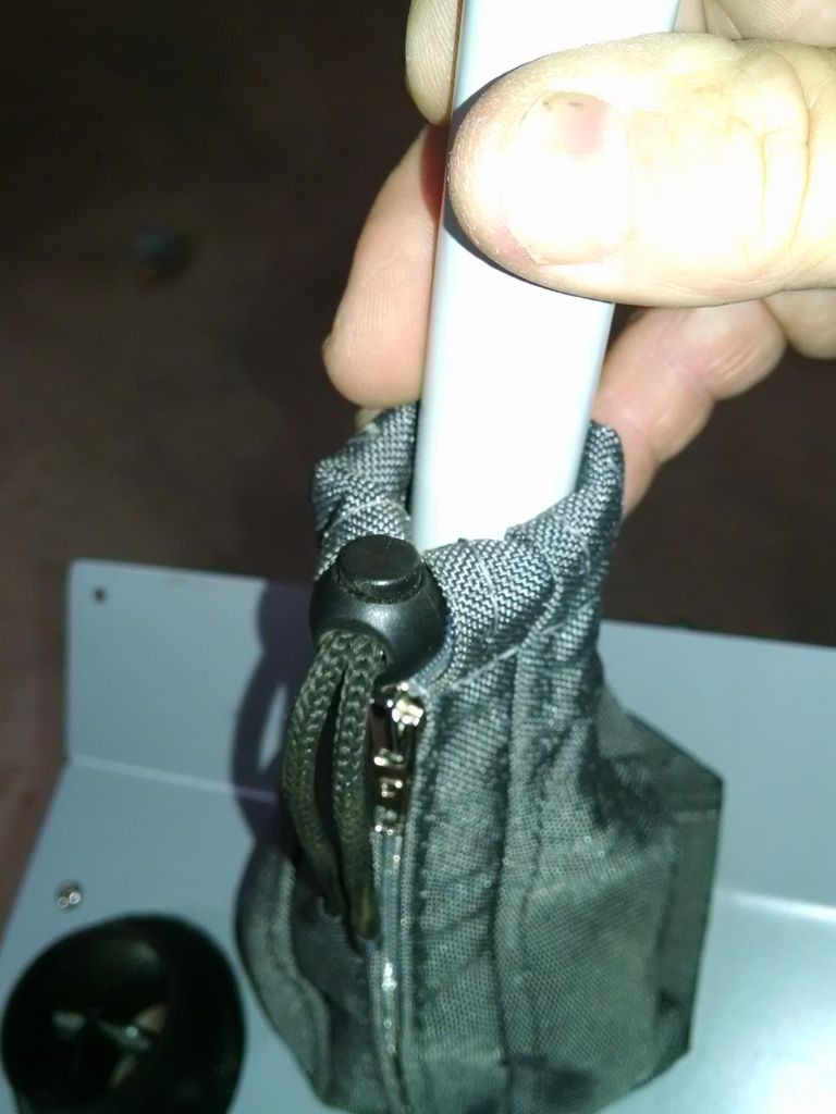

Way safer then those C clips. Short bead chain to keep the pin with the stick and not lost in the tunnel
Then covered with stick boot
