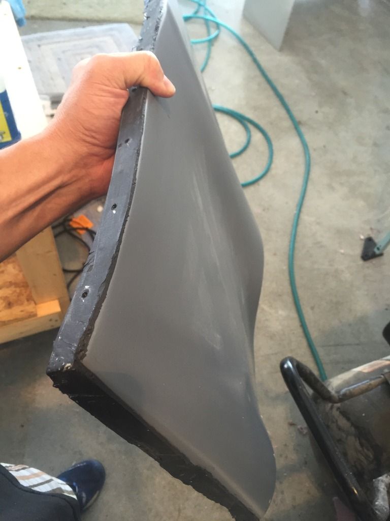

I'm curious what others are using to seal their plenum to the metal baffling.
RTV would seal and be easy the first time but would have to be cut and re-applied every time the plenum is removed.
I've also thought about RTV/pro-seal/weatherstrip adhesive stuck to the plenum and molded in assembly with taped/waxed metal baffling to try and make a re-usable seal.

That's not a bad idea, but I would have to allow for the thickness of the material when I laid up the plenum. As it is the clearance is too tight for the baffle material. I ended up using Ultra Black stuck to the plenum and taped/waxed the baffles. I used clecos and light screw pressure to not squeeze out all the RTV, torquing down the screws for final assembly should make a nice tight reusable seal. We'll see.....
