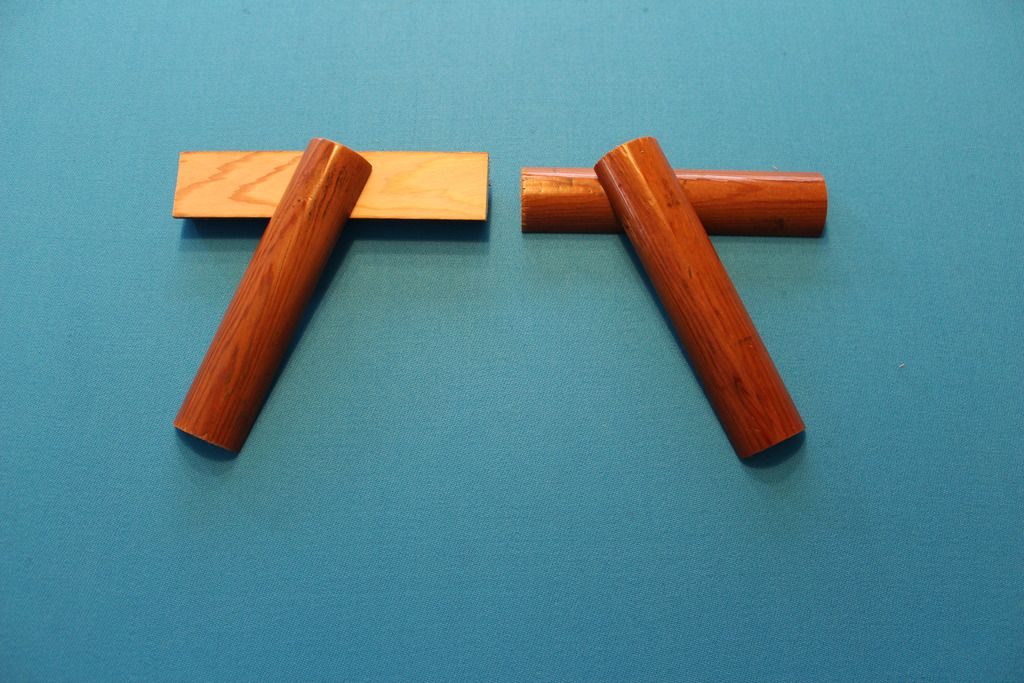

I read occasionally about the problem of dragging the brakes while taxiing because the throw from brake off to on is only about 1/4". I realized this on my first RV mainly because I have size 12's and my toes were always midway up the pedals even when my heels were on the floor. Very easy to inadvertently be slightly depressing the brakes without meaning to. Here is the solution. Also, I might add, similarly adapted by Cessna by building it into the pedal design. Anyway, here is what you do: Either get hold of some 1/2 round dowel or create you own( I used an old closet hanging pole) and cut it slightly shorter than the width of the brake pedal. Then simply adhere the 1/2 dowel to the lowest edge of the of the brake with double stick tape. Now when you are resting your feet on the floor you will be pushing the brake pedal backward until you raise your toes above the dowel. Easy fix and has worked really well on my past 3 Rv's. The photo shows the dowels that will be installed next week on our new 14.

Lots of us zip tie lengths of fuel or heater hose around the horizontal segments of the rudder pedals for the same reason. The half-round probably gives a little better stand-off distance, but I suspect the zip-tied hose will do a better job of staying where you want it.

I'll post another pic when I have installed the dowels on N199MJ. I use VHB double stick tape and they never move unless you want to take them off. Putting hose around the rudder pedal below the brake pedal won't guarantee that vibration won't cause the brake pedal to occasionally rock back and forth and be tapping the brake pads on and off the disc. Anyway, that's my personal logic. Cheers

Default More pics "wood" be helpful
but I think he is talking about adhering these to the lowest part of the flat brake pedal (below the hinge pivot line?), not the cross tube below.
I agree, but the intent is the same - eliminate or reduce inadvertent brake application.

For any of the side by side models all it takes is positioning your feet so that your toes point out outboard slightly so that you are pushing on the outboard (relative to your feet) side tube of the rudder pedal assy, rather than the brake pedal.
If you need brake it is then requires just a very small movement of your toes inboard so that they land on the brake pedal portion of the rudder pedals.
Sounds more complicated than it really is. With just a little practice it becomes second nature.

This is a common complaint. I believe a commercial strap-on product is offered by some outfit.
The simple fix to the lousy Van's design for the brake pedal is to turn 'em around so the 3/4" angle is on the face (the surface you press on). This sets the plate surface forward 7/8", producing the same effect as strapping on a riser to the face of the rudder bar. You can also tip the pedal top edge somewhat forward during fitment, but go easy on this as your ankle doesn't have much range of motion in this direction - essentially standing on your tippy-toes.
