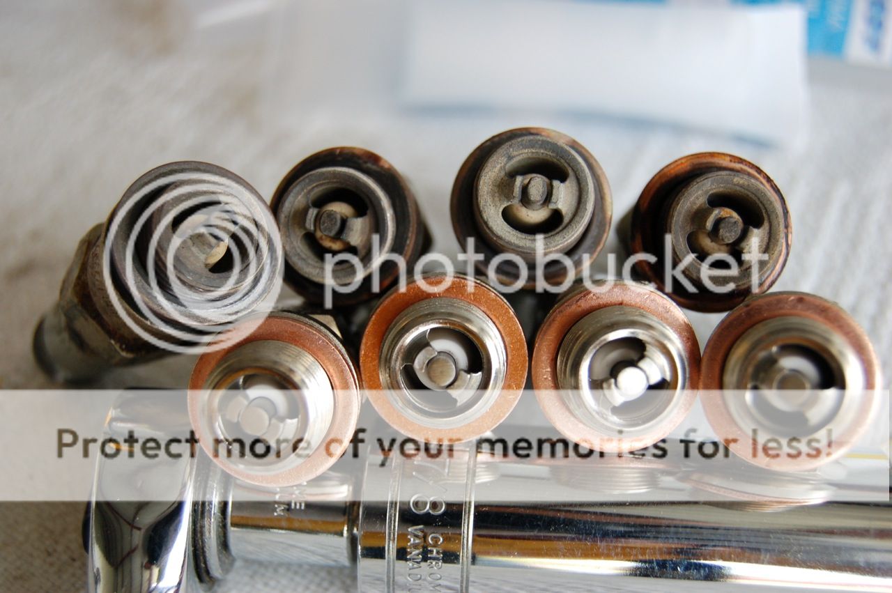

Every tool, and every video, I've watched all show you how to compress the spark plug electrodes to reduce the gap.
I have new spark plugs and the gap is too small. What is the correct way (or tool to use) to spread the electrodes?

http://www.aircraftspruce.com/catalo...despreader.php

The important thing is to never apply pressure against the center electrode.

Originally Posted by Sam Buchanan View Post
So with this tool you slip it behind the ground electrode and pull on it - making sure not to contact the center electrode? Or?

Gary the gap on new spark plug looks tight indeed but it's an illusion I wouldn't touch it. Measure you will see. The geometry of shiny new electrodes is different from the worn ones. Go fly with factory gaps and report back
Not exactly. Yes, slip it behind the ground electrode and then pry it up. The fulcrum is the threaded body of the plug adjacent to the electrode. So, it is not a "pull", it is actually a push on the handle.
