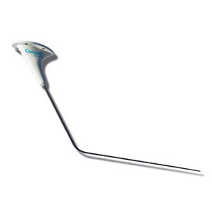

A local RV-6A pilot reported he lost the metal portion of a bent whip belly antenna, one just like this -
It broke just where it exits the base portion.
