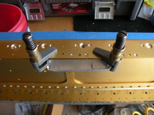

I didn't care for the thought of running a countersink pilot in the nutplate threads as recommended in the instructions, so I made a jig (Photo 1) with a # 30 hole for the countersink bit pilot, and two holes for rivets to be used as locator pins. The rivets can't protrude above the spar flange, as they would interfere with the foot of the countersink cage, so I used 0.125 stock to make the jig and 3-3 rivets (3/16" long). I taped the rivets in place, and used cleco clamps to hold the jig in place for countersinking (photo2). I had to add a different set of holes on the edge of the jig to allow room for it to be clamped to the #6 access cover nutplate holes (photo 3).
Also, cutting those big countersinks can generate enough chips that it's hard to tell when you're done with the countersink. It helps to have someone hold a vacuum cleaner to suck up the chips as you work.
