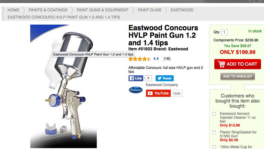

I purchased my paint/primer gun from Eastwood with the 9oz DeKups cup system. Very pleased with the quality of the job it does.
