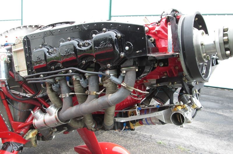

Here are a couple of photos of the supercharger setup on Bill Beaton's Rocket. Test flying is proceeding as weather permits. Slowly working out the bugs, hopefully in time for Reno.

That's quite a prop extension on an already extended hub Hartzell...
Got any pictures of the cowl?
I have started my EFI installation, so I'm looking forward to hearing some performance numbers from this beast (not that my little 260 is going to compare...)

Default Prop Extension
I probalbly have a picture of Bill's plane with the cowling on. I'll post it if I have time to dig it up. I agree, there is a lot of potential load on the nose of that crankshaft between the extended hub prop, the extension, AND the centrifugal blower drive...

Bending loads through the extra moment would be the bigger concern. The radial load from the supercharger drive is tiny percentage compared to typical firing loads on the bearings.
It's all very experimental however...
Here's a video link of it running a couple weeks back. Note the smooth note with EFI and the cool supercharger sounds.
