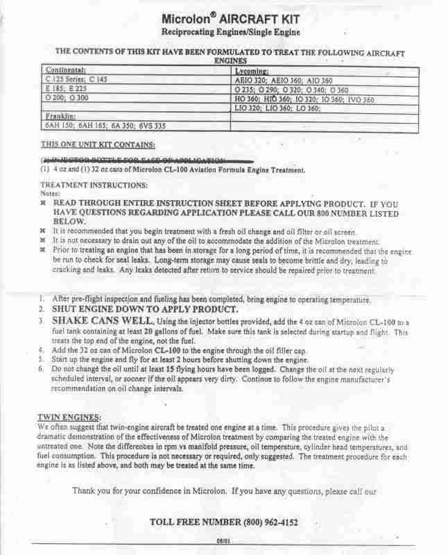

There was a more recent thread on this but I couldn't find it in a brief search. In that thread I said I would buy it, test it and report my results. I ordered the Microlon from Aircraft Spruce for $119.95 and the shipping cost for Fedex Ground was $13.61. I use Aeroshell 15W-50 which aready contains additives. When I changed C/S props recently I saw evidence of buildup on the walls of the cavity in the crankshaft behind the prop before ordering the Microlon so there may be some conflict in the application but a promise to test is a promise to test. I received the order today (1-15-10). The product comes in a "kit" which consists of two cans and an instruction sheet. The large can is 32 oz. and it is labeled "CL-100 Engine Treatment." The small can is 4 oz. and it is labeled "CL-100 Fuel System Treatment." The situation here at home is such that it will be a while before I can run the test (probably in February) but I will give it the best checkout I can. Images of product and instructions below. Logistices of a fair test should not be a problem since I have to run the engine before the installation and after so the configuration will be the same. I currently have three wing configurations and I am working on another. The best (fastest) one is not installed but it will be before the test is run. The best speed I have established so far is 184.4 kts but I am working on two new mods that have not been tested and the new blended airfoil prop that has not been tested in the fastest configuration. In the current configuration the prop did produce the 3 kt gain expected. Since I have a Hartzell C/S prop, I expect the prop speed to remain the same but the pitch to increase and any improvement will be measured in aircraft top speed. If the manufacturer's claims are applicable to my airplane I should see something on the order of 192 kts. We will see.

A local pilot here has had great results, more power and lower temps. BUT he followed the instructions exactly and apparently is very important because the particles are not in suspension. Namely, you must SHAKE WELL and apply to a hot engine then fly immediately at high cruise power (not circuits). I think his memorable flight was over an hour where the temps came down during the flight and RPM increased.
His report has made me curious. I too wonder about the material stopping in the filter and blocking oil galleries but his results were impressive
