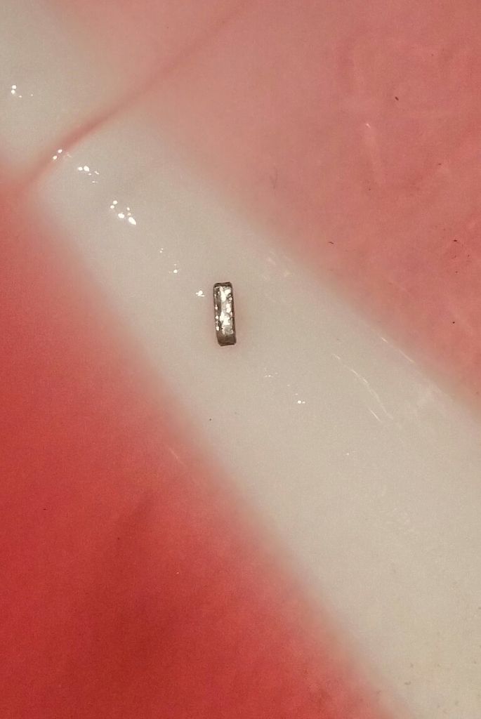

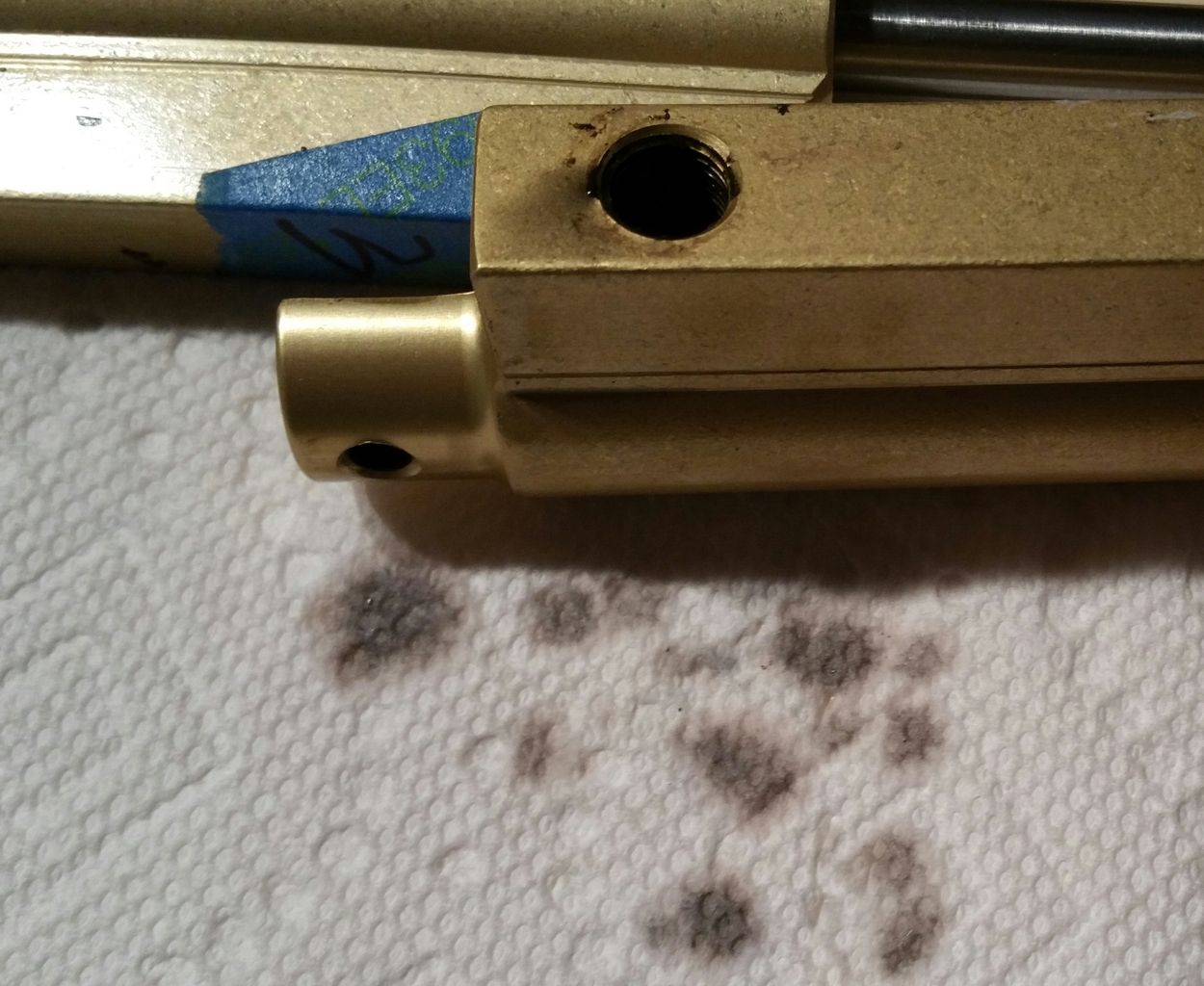

2. The dripping fluid appeared to be "dirty" this time instead of clean red. I presumed it was just picking up some grit from the floor. But when I removed the cylinders and shook them out on my workbench, at least two of them dripped some blackish fluid out. You can see it in the picture below. I also attached a picture of some fluid that ran out of the lines when I pulled them off of the cylinders in the plane. It looks mostly clean except for the small piece of metal that may have come out of one of the lines. Does anyone have any ideas about this?

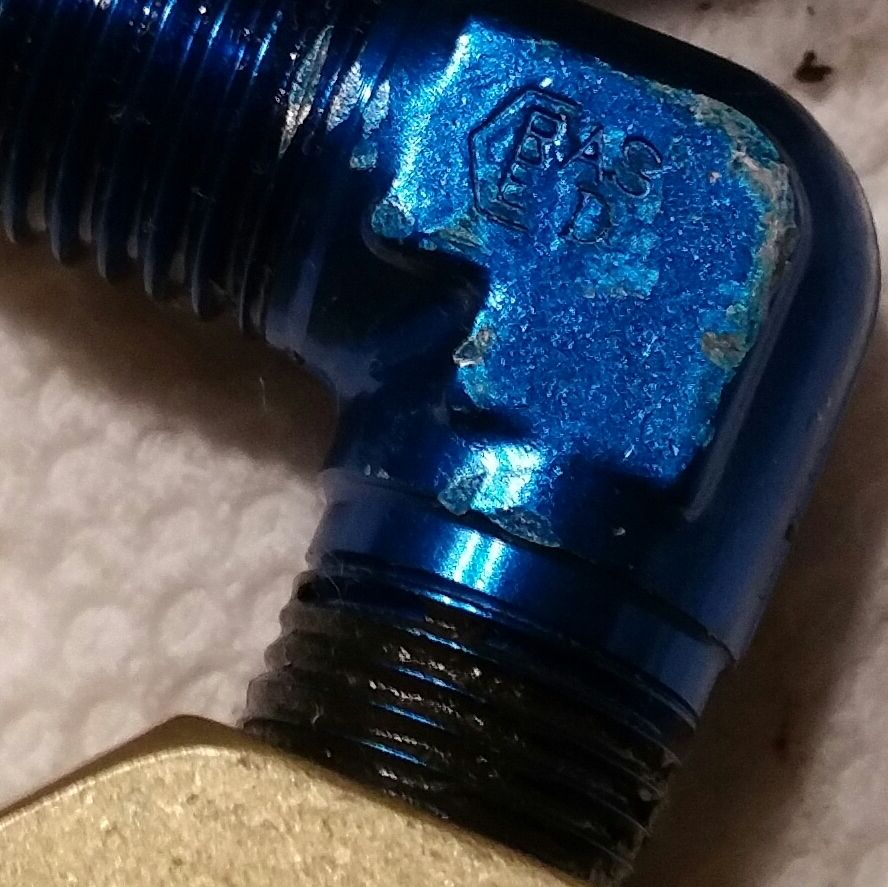

3. I was able to do a decent job cleaning the threads on the fittings with a combination of alcohol bath, a metal pick, and a wire brush. The cylinder female threads are going to be a lot more work. Are there any tricks for these threads!? I imagine I am headed out to a gunshot to buy a small copper bore cleaning brush. Is copper even safe to clean the cylinder threads with?

Check the depth of the threads....... Matco has, in the past didn't tap deep enough. Just shorten the fittings by 2 threads to allow it to make 2 more turns if needed.
The color of the fluid could be from the fluid not being compatible with the matco parts.
These are interesting ideas! What I did find when I cleaned the parts and threads was odd. I have at least 2 different fittings, maybe more. They are different in the color of the blue anodizing, different in the length of the threaded portion (at least on the cylinder side), and the cylinder threads themselves had what appeared to be deeper of flatter sections of thread in places. That is, if you looked into the opening fitting hole and rotated the cylinder, there were several sections around the thread hole that seemed to have mashed or flatter threads. These areas were like lines about 3/32" wide from the outside to the inside across all the threads. I didn't get a picture of it though. And lastly, I have one fitting that is wider at the bend than the others. I can easily slip a 3/8" (???) wrench over them other fittings to tighten or remove them. This one fitting has to be nearly 1/16" wider and I need to use an adjustable wrench instead.

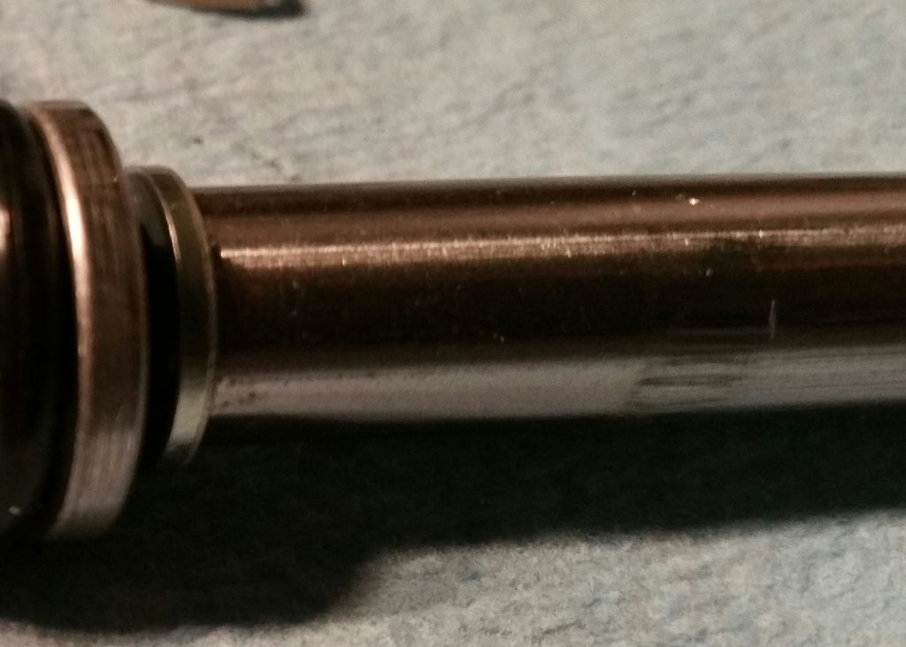

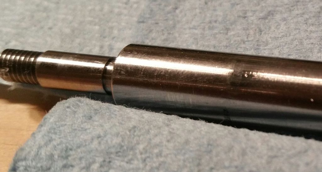

One last thing of note is there was scuffing on all of the shafts. I have no idea if it is significant but I though I'd ask. I think I am going to call the Matco guys back and see what they suggest before I begin any more home remedies. But I would still be interested in any feedback. I rebuilt the dripping cylinder and replaced the shaft but that is all the new shafts I had so the others are disassembled on my bench still. I don't mind tapping the threads but I don't want to do that until I run out of other options I guess.
This just sunk in. I will pull the clean fittings back out and check the uniformity of the thread depths. Hence the bottoming tap! I think I also need to order some more fittings so at least I know I have a uniform group. I have a set of steel fittings for this purpose but they weigh way too much for me to want to use them now.
I had a leak on one of my cylinders prior to first flight. It always looked like the leak was coming from the brake line fitting but no matter what I did, I would always find more leaking fluid the next day. I finally removed cylinder and disassembled it finding a small piece of aluminum lathe turning chip inside that damaged the cylinders piston wall and "O" ring seal. I de-burred and buffed out the groove and replaced the "O" rings. Problem solved. Basically the same thing with my parking brake valve. Persistent leak prior to first flight. No debris found there during disassemble however new "O" rings did the trick.

If you are enlarging the pipe thread in a closed bottom hole, you can do it by carefully grinding off the end of the pipe tap. Then tap a little deeper until it bottoms out. Then grind off a little more of the end of the tap and do it again until your fitting can fit properly.
With the NPT I remember this being a pain to get the correct TQ and have the fitting pointed in the correct direction. I erred on the tight side for no leaks, one more turn errrr Come on!
It sounds very much like a thread issue. You don't need to be out of tolerance on a tapered thread to have it go too deep or not deep enough. The NPT fittings from Summit Racing are very popular because they are from China and are way cheaper, but I bought some for my oil cooler lines and the 90 deg ones only went 1 1/2 turns into the acc. case. They were a few thousanths too big in dia. If you had a fitting that was a few thou too small you would bottom out and it would never seal. I don't know if that is your problem, but that is where I would look. If threads are damaged that is a sign that something went wrong. NPT threads in good shape with sealant don't leak. If yours do the threads are damaged or not well formed etc. Try different fittings, try cleaning up the threads very carefully with an NPT tap, make sure you are not bottoming out. It could also be that the thread is poorly formed in the cylinder so it goes too deep.Those are the things I would look for.
