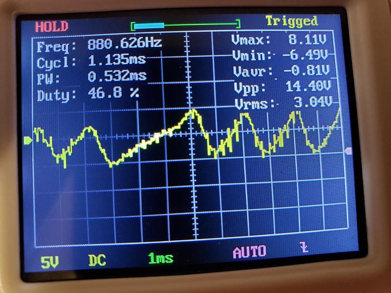

I received the gear I ordered and modified it to use for timing. Also installed the pickup. Took the assembly for a spin on the lathe.
Colin P.

What wire gauge did you use for the coil pack? The megajolt manual recommends 14awg, but that seems like way overkill given the reported current draw. Also, 14awg shielded is proving hard to find. 16awg should be plenty sufficient. Thoughts?
On a side note, pickup assembly is all together and ready to roll. Need to get the rest of the system wired
