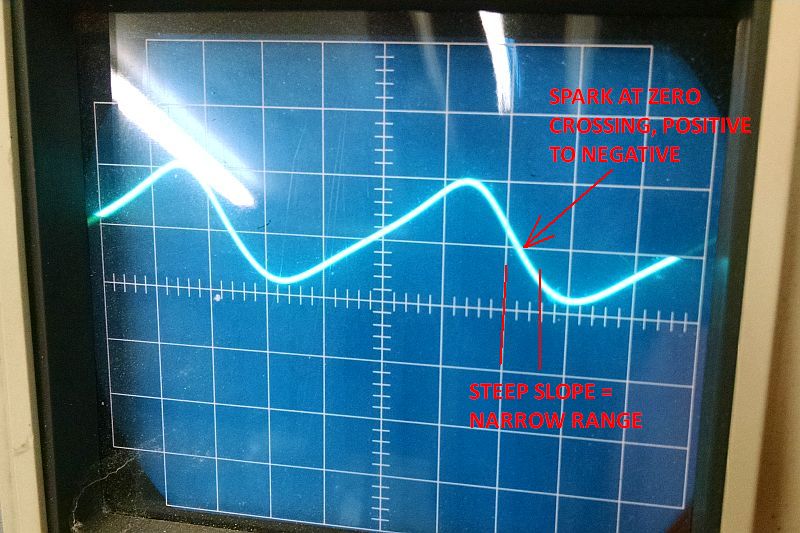

Bob, almost anything which provides 35 teeth and a skipped tooth space will work. The Lycoming flywheel has 12 AN4-sized mount points, so for a first pass, I drew this, and Kirk (that's Kirk Harrel, the Mustang II owner) turned it out on his mill. It's a steel plate, 3/16" thick IIRC, cut on a rotary table. It would be real easy to do on a waterjet; hand the operator a .dwg file and a few bucks. Flywheel = gray, trigger wheel = white. A standard Ford pickup points forward (at the sides of the teeth), much like the mount you've seen for hall effect triggers. Note small alternator pulley.

Make the tooth width the same as the width of the tip of the pickup; that nets a clean sine wave signal for the EDIS module. See the blip on the right? That's the passage of the skipped tooth.

Lest anyone think the basic tech is unknown in airplanes, this is a Electroair mag hole trigger...60 teeth less 1, tubular magnetic pickup on left, which can be used with a 36-1 wheel also. It will be same output waveform as in the previous photos, and Electroair sells them in two sizes. Me? I like the ND pickups, reliable and very compact.

Not much on Ebay is going to fit the Electroair shaft. The easy way to adapt one to EDIS would be to simply re-machine the existing wheel, which is really a disk about 1/8" thick. Lop off the 59 teeth, cut 35, and slide the pickup inboard a wee bit.
The disk is clamped to the end of the shaft with one allen screw and Loctite. There is a tiny roll pin under the cap to safety rotation, but I'm not real impressed. The pickup just clamps in place with set screws.

Bob, almost anything that provides 35 teeth and a skipped tooth space will work. The Lycoming flywheel has 12 AN4-sized mount points, so for a first pass, I drew this, and Kirk (that's Kirk Harrel, the Mustang II owner) turned it out on his mill. It's a steel plate, 3/16" thick IIRC, cut on a rotary table. It would be real easy to do on a waterjet; hand the operator a .dwg file and a few bucks. Flywheel = gray, trigger wheel = white. A standard Ford pickup points forward (at the sides of the teeth), much like the mount you've seen for hall effect triggers.
BTW, a little design tweaking would save weight, but for those who have rear CG concerns, well....
Make the tooth width the same as the width of the tip of the pickup; that nets a clean sine wave signal for the EDIS module. See the blip on the right? That's the passage of the skipped tooth. This is the signal from a Ford pickup, and the large toothed wheel drawn above....
....and this is the signal from a Nippondenso pickup, with a 36mm diameter wheel made from a cut-down gear...the shop-made mag hole trigger on the previous page:
