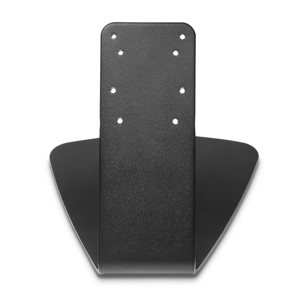

BSwayze's Avatar
BSwayze BSwayze is offline
Join Date: Jul 2007
Location: Molalla, Oregon
Posts: 955
Originally Posted by g3xpert View Post
Hello Jeff,
You can probably guess how badly we wanted to re-use the mounts used so successfully on the aera 5XX since 2009. Ultimately, we felt more strongly that the 660 should have 2 serial ports instead of the 1 used on the 5XX, so were forced to change the mount. You can't actually insert a 660 into a 5XX mount or vice-versa due to a mechanical feature that prevents this.
Steve
Steve, if I may ask a follow-up on this question about the new panel mount... I cut a small cutout in my panel and installed the mount for my Aera 500 directly to the panel. If I upgrade to a 660, I understand from your answer in Post #5 (quoted here) that I need the new 660 mount. My question is, will I be able to just swap it out with the mount I currently have for the 500? i.e., are the dimensions and layout for the 4 screw holes the same? Or will I have to do more cutting and drilling?
Bruce Swayze

g3xpert's Avatar
g3xpert g3xpert is offline
Join Date: Sep 2010
Location: Olathe, KS
Posts: 2,882
Post
Hello Bruce,
Yes, the mounting pattern and physical size of the aera 660 bare wire mount is the same as the aera 5XX, so you should be able to install this new mount in place of the aera 5XX mount should you choose to do so.
Additionally, since the aera 660 also supports portrait operation, you may rotate the mount 90 degs clockwise and use it in portrait mode as well, but of course that would take a little modification of your existing installation. In the portrait mounting orientation the quick release button is located in the lower right and also easy to operate in that position.
