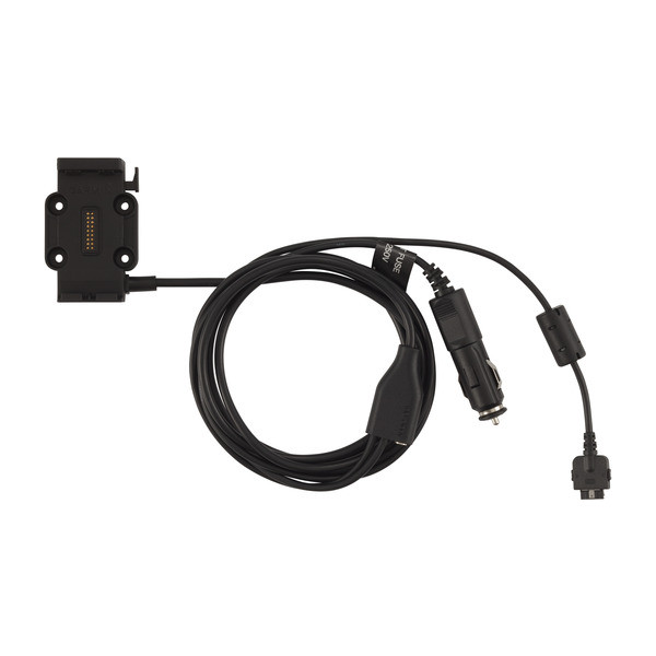

I would like to purchase a 660 and GDL 39 3D. Which cable do I need order or does it come with one? I was looking at the GDL on AS and I don't see an option for the 660.
Also, do both include a power cable? I would like to have them powered from the aircraft and not rely on battery.
Hello Nippaero,
Good plan. Some of us don't want anything in the plane powered on batteries unless we lose the alternator! :)
To connect your aera 660 to a GDL 39 or a GDL 39 3D and power them both from a cigarette lighter adapter, you would need this cable.
You could also use a bare wire mount/cable like described in the original posting. You would also need the bare wire cable for the GDL 39 if you go this route. This is how I have installed the aera 660 with GDL 39 installed in my plane. The second serial port brought out by this cable is connected to a G5 with autopilot.
I found all three of these cables for sale on the ACS website.
Let us know if you have additional questions.

Thanks. I would rather not use a cigarette lighter for a clean installation.
I guess my question can I select the bare wire option when I order the GDL? Would it come with that cable or do I need to purchase it separately? I do not see the 660 listed as an option on AS. I just want to power the GDL and still se Bluetooth for the 660/Ipad.

Thanks. I would rather not use a cigarette lighter for a clean installation. I guess my question can I select the bare wire option when I order the GDL?
Yes, as shown in your picture, you can select to purchase a GDL 39 3D with bare wire cable and purchase them together.
The GDL 39 3D can be ordered with the bare wire cable.
We understand that you wish to use a bare wire harness on both devices, so you will order the GDL 39 3D with the bare wire harness, order the basic aera 660, and order the aera 660 bare wire mount.

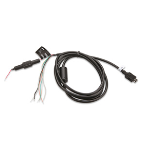

I have the GDL 39 using the cigatette lighter for power hook up. I would like to hard wire the GDL 39 to my Aera 660. I will also hook the Aera 660 to my GNS 430W.
The smaller picture of the bare wire which I think you show as being for the GDL 39 does not seem to have the type of connection that goes into the GDL 39, I can't seem to find the bare wire for the GDL 39 for sale, I know it can be ordered that way.

Hi Mike,
First, the cables. Yes, I agree that the GDL 39 bare wire cable picture doesn't look like it has the GDL 39 connector on it, but it does. You will need that cable plus the bare wire cable for the aera 660.

I'd like to use the wired in mount to get the 660 in portrait rather than landscape and I can't do that with the include yoke mount. Do you know what RAM piece I can screw the Aviation Mount with Bare Wires (Part Number: 010-12373-01) to?
I believe Steve previously indicated that the mounting pattern for the Aera 500 series was the same dimensions as the Aera 660 (but pinouts wouldn't match).
If that's the case, this RAM mount [RAM] [Aircraft Spruce] should bolt directly to the hole pattern on the bare wire mount. It uses a 1" ball, so any of the RAM 1" ball hardware should work to take it from there to your panel.
Rob is correct (and thanks for posting the picture).
The aera 5XX and aera 660 use what is called an "Amps" rectangular mounting hole pattern that is widely supported by third party mount suppliers.
We have a 1" ball mount installed in our RV-7A (attached to the side post) and use a ball mount attached to a cable mount like Rob shows above when we fly with the aera 660. It is hard to beat the flexibility of the ball mount options.
Steve
If that's the case, this RAM mount should bolt directly to the hole pattern on the bare wire mount. It uses a 1" ball, so any of the RAM 1" ball hardware should work to take it from there to your panel.
Excellent! That is what I was looking for. Thanks
Steve

Steve,
I have a Dynon D100, GDL39 3D, and need to connect the Aera 660.
The Aera 660 will be hard-wired in the panel, replacing a Garmin 296. This previous installation worked well, navigating with the D100 autopilot.
Understand that the blue & yellow connect to the RXD & TXD at the GDL39.
Can I simply parallel the D100 via the blue TX1 wire as well? Or use the orange TX2?
You provide great response, and I don't want to smoke anything, so I'm asking.
Thanks in advance,
Bryan
Steve,
Thanks in advance,
Bryan
Hello Bryan,
Thank you for your kind words and for replacing your 296 with an aera 660!
The GDL 39 3D requires a dedicated serial port, but no problem since the aera 660 has two serial ports. Just wire up the GDL 39 to the Blue and Yellow wires for serial port 1 like shown in the diagram on page 144 of the aera 660 Pilot's Guide and configure Serial Port 1 to "Garmin Data Transfer".
Connect your D100 to the Orange TX2 wire and configure Serial Port 2 for "NMEA Out 4800" or "NMEA Out 9600" depending on the baud rate of your D100.
Steve
