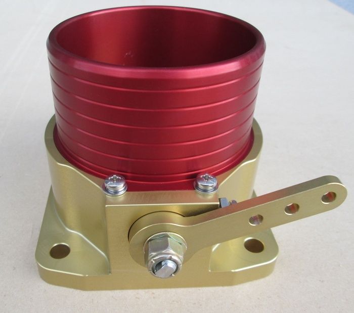

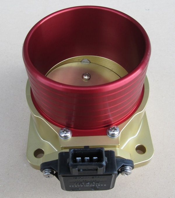

For those thinking of replacing Bendix style mechanical injection with EFI, we now have CNC'd throttle bodies to bolt directly in place of RSA-10 servos on forward facing IO-540 sumps.
The throttle plate is 80mm and the air horn base accepts 3.5 inch ID SCAT hose, K&N filters or rubber couplers. The TB has an O-ring seal on the base so gaskets are no longer required. The shaft is Stainless, supported on sealed roller bearings. The throttle arm is 7075T6 and incorporates internal stops. Under 2 pounds total weight and mounts an OEM Bosch TPS. There are no internal restrictions like on mechanical servos so the body offers full manifold pressure potential up to 375hp.

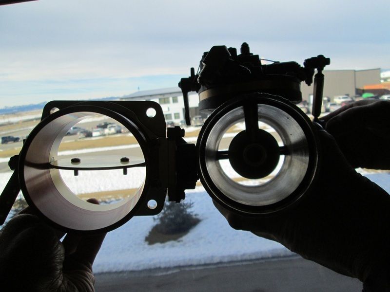

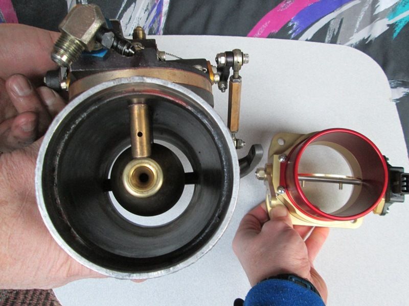

Aircraft mechanical FI metering systems must have a restriction to function.
Yes and no. A dual diaphragm fuel control actually receives a significant percentage of its air diaphragm force from dynamic pressure, and the only restriction that entails is a mast to place a pitot in the airstream. Bendix-style units do restrict the whole throat diameter to generate a vacuum signal for the other side of the air diaphragm, but an AFP control does it with a tiny little venturi in the middle of a much larger primary passage. The majority of the passage is not restricted, so carb loss is reduced in comparison.
Here, take a look. This is an RSA-5 and its bolt-on replacement, an FM150, which has 2.75" less drop at 1560 lbs. Note the straight sides in the FM-150:
Of course the shaft and blade present restriction to airflow and mechanical servos have these too so that part is roughly the same.
An accurate statement.
Don't get me wrong. It's a nice piece, and it absolutely should record less carb loss than a diaphragm fuel control....but it ain't a zero loss device.

Total open area minus obstructions and throttle shaft:
80mm 7.0 square inches
FM-300 4.065 or 5.84 without the shaft area figured in.

Always trying to make product improvements based on customer feedback.
We've just done our 3rd run of 80mm throttle bodies. This time we addressed the lack of vacuum taps on some of the IO-540 intake manifolds by adding 4 threaded holes (2 on each upper/lower flange side) to accept hose barb fittings.
The 2 not used can be plugged with the provided Allen screws. We provide 2 barbs as well.
