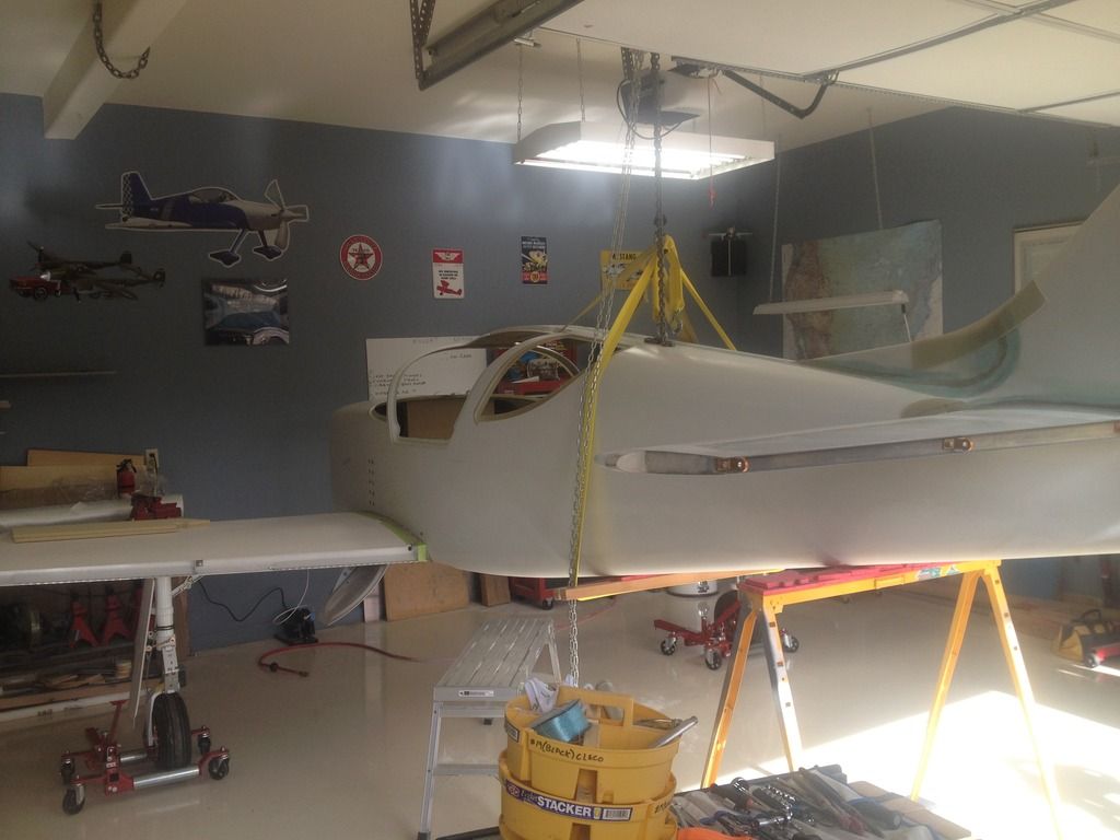

Default glass
I built an F1 and now am in last year of a GIIIRG. Glass is not tough, just itchy on a large scale. Metal is more fussy with all the bits and pieces. Both are very satisfying. Engine is a TIO540AE2A. Think Jeff Lavelle and Reno. N360KT reserved.
[IMG][/IMG]
[IMG][/IMG]
Best
Howard
