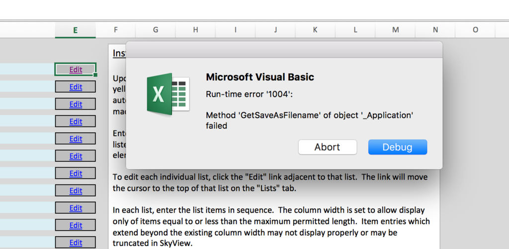

I finally got my, fairly complex checklist file to work. No, I didn't use the Dynon Tool. I couldn't get the tool to save a file.
But, I did manage to get my handcrafted text file to work using the troubleshooting technique that Dynon suggested. I sequentially commented out, using the # symbol, each individual checklist section. That helped me find the errors. It turns out that a missing period, and two periods that should have been commas, were causing problems.
The Dynon provided EXCEL tool seems like an excellent aid but I couldn't make it work either. When I tried to save a file, I got this message.
I applaud Dynon for making the editing tool available. It is exactly the sort of approach that a company like Dynon should take. Nobody should have to go through the text file editing process to get a checklist upload to work. The product is just too great for that kind of Mickey Mouse stuff.
I'm sure the Excel tool will be working great soon or they'll come up with some other user friendly editor.

Randy,
I can see from the screenshot that you have a Mac....
The reason we started with a text file is so that any computer running any OS can edit it. We knew if we released a proprietary file format and then made a Windows utility, it would be only seconds before we were told by all the Mac and Linux users that they were left out. We're pretty happy that so far, all SkyView updates and files can be done on any OS.
However, the Mac is why the Excel tool didn't work. As we've now found out, all the script functions available on Windows in Excel are not available on a Mac, and they are needed to cajole Excel into making the file we need. See, we try and do a good deed...
We're looking into how to serve Mac users better.

FYI, the scripts are there to do data validation, but also to allow directly saving to a text file in UTF-8 format. It's the UTF-8 call that isn't supported on Macs. I don't think you can trick Excel into saving into a text file with the formatting you want without a script.
