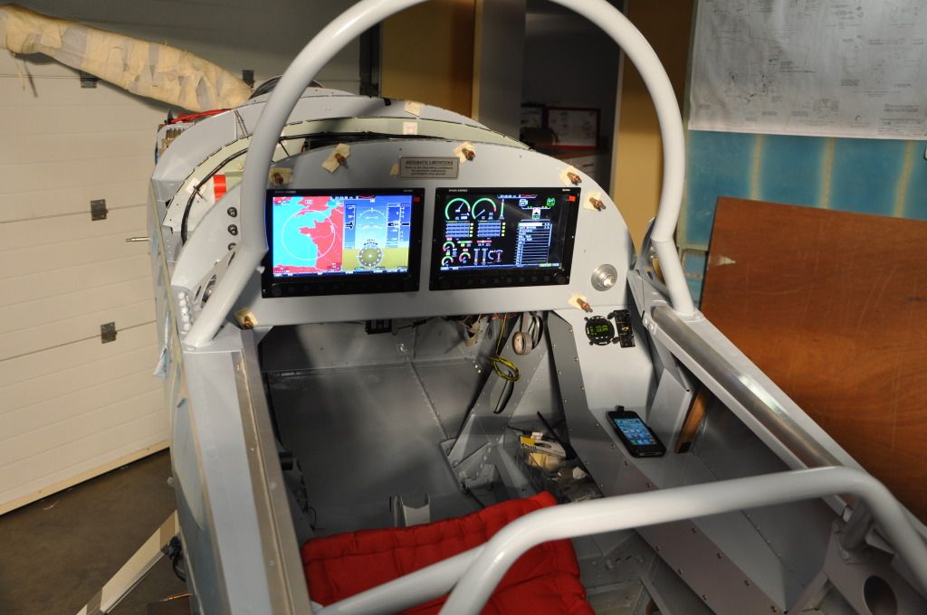

Don't forget, you can put two 10" SkyViews in a RV-8:
Wish I could but I need some round gauges and standard-width avionics too:
Now, if Dynon would make a 7-inch portrait-mode screen I wouldn't need a tablet on a ball mount but I understand the realities of that. It's too late for this panel but a higher-resolution 12-inch screen would have worked for me.
