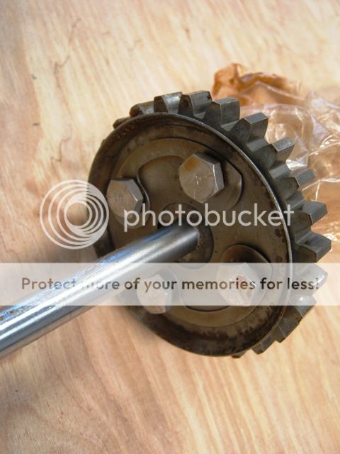

My parts catalogs (both the current one, and a 1984 version that I have) only show the 1 piece cam. I found this picture in the Overhaul Manual:
I have the gear, slinger, and 2 lockplates. I will need to source the other parts.

Here is my camshaft assy. before it went to the assembler. You can see the two bolt retainer plates and the formed sheet metal "SLINGER, Breather" under the bolt heads.

Is the rod in the center the "Tachometer shaft"? I think it would be OK to omit those parts (tachometer shaft, tach shaft spacer), what do you think?
My lockplates are probably OK but I'd like to get new ones. I"m not sure if they should be reused.

I'm pretty sure you need to install the tach drive shaft. The covers for the tach drive(Spruce etc.) are just dust covers and would not create an adequate oil seal.
The locking plates should not be reused.
The cam gear bolts have probably been superceded. Dart Aircraft in Waco TX might help with superceded parts. They have Lycoming ECI and Superior.

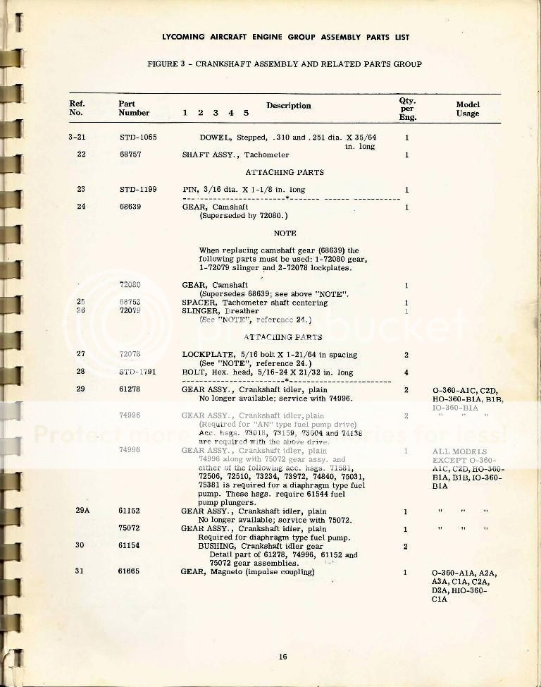

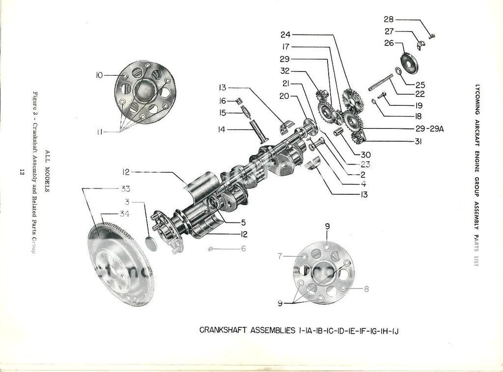

An old O-360 parts manual -
Hi Gil - can you post the picture that goes along with these parts? It looks like I need Item 23 (STD-1199, "Pin - 3/16 x 1-1/8") as well. The figure would sure help.
Not one of Lycoming finest - the viewpoint is poor -

Because part #23 goes cross-wise to the camshaft, I think it is the early equivalent of the pin that retains the tach drive in the later one piece camshafts. Same diameter, but now 2 21/64 inches long.

Thanks Gil - both pictures help a lot.
You are right, the Lyc drawing doesn't show this clearly... but I find those old hand drawn pictures strangely beautiful. Much nicer than modern CAD stuff.
You stolen photo is really good to show the tach shaft on a modern camshaft. It shows that the tach shaft (and its crosswise pin) is installed on the outside of the camshaft gear. Looks like it is held in with a snap ring.
Your stolen picture inspired me, so I stole this one: I think it is similar to what I will have:
This shows a 2 piece cam - the shaft/pin is installed between the cam and gear. I think it still floats around a bit but can't be removed without taking the gear off.
I'll find a servicable tach shaft - the pins are still available. This is a bit annoying because the tach function will never be used.
Thanks again for the pictures,
dave
