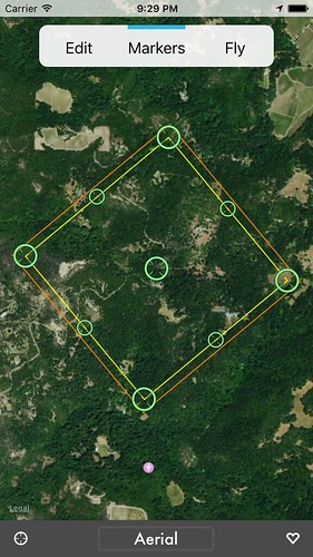

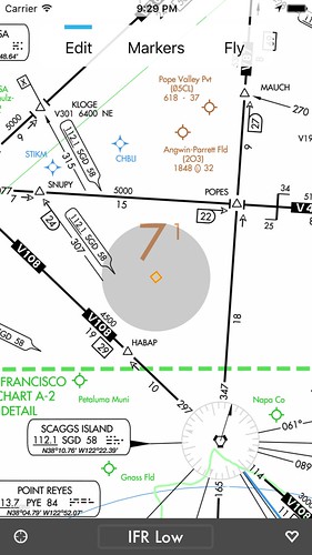

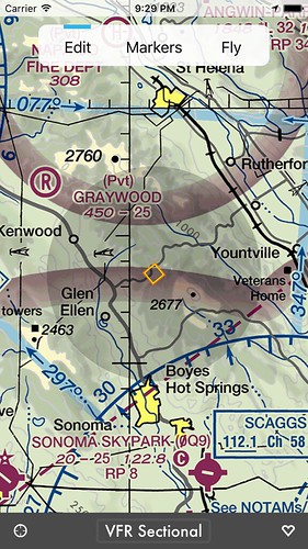

AcroBox lets you define the boundaries of a virtual aerobatic box compliant with the International Aerobatic Club's specifications and FAA regulations. Use the VFR and IFR charts to ensure that the box doesn't encroach on federal airways or airport surface areas, then use the aerial map to visually identify box boundaries. If you're setting up a box for a club or competition event, the "marker" mode shows exactly where the box markers should be placed.

Seems the area around the box is just a 5 mil radius. Regulation calls for 4 miles of the center line of an airway. So what you really want is to shade the area within 4 miles of the box outer boundary. Believe it or not in my area ( northern NJ ) that makes the difference of being legal or not..... .
