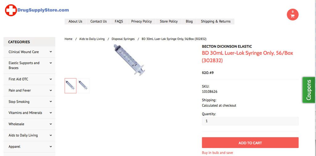

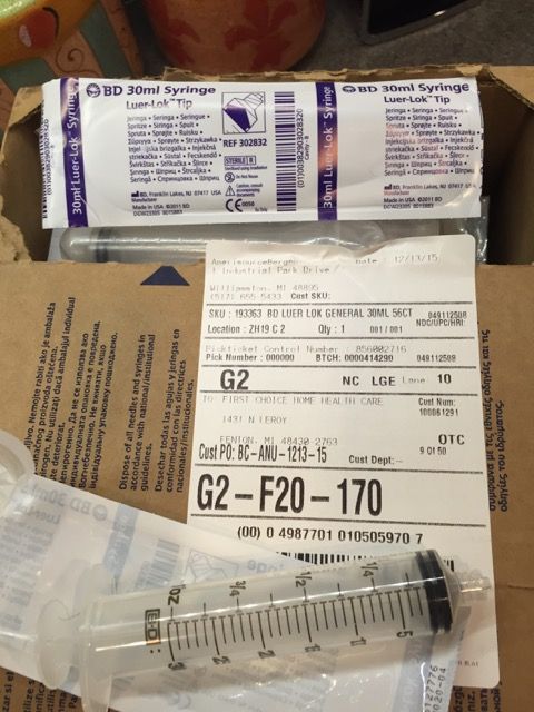

Received these 30ml / 1 oz syringes at a very good price from DrugSupplyStore.com. Price $20.49 (plus shipping - mine was $10) for 56 count box, each syringe packaged in separate sealed pak - nice touch; syringe cost each $0.54.
ID of syringe tube 7/8", popsicle stick-friendly. Can drill out needle end receptacle up to 9/32", for an adequate ProSeal flow.
Here's pics >
Site syringe description.
Syringe / pak.

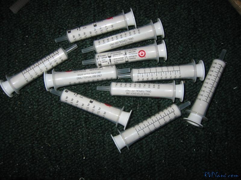

When I was doing my tanks back in 2006, I was able to get free syringes from the pharmacy counter at Target. They worked PERFECTLY for sealing the tanks, and the price was right!
