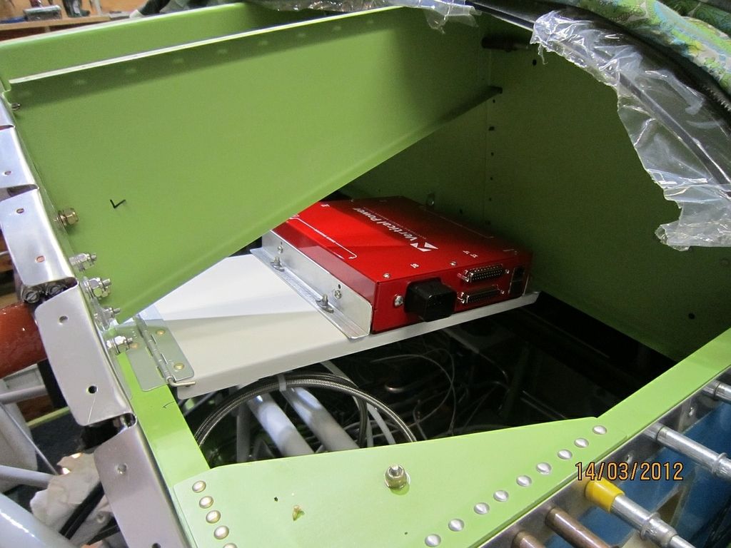

May I suggest swing down panels, hinged at the firewall and secured to the mid subpanel with 2 Camlocs. Unlocking the Camlocs allows the panel to swing down resting on the pedals bar and allows good access to the wiring and plugs.
By pulling the hinge pin the whole unit can be removed. Mine has VP-Pro on one panel and Dynon back up batteries, transponder and Live battery bus on the other. The balance of the items (EMS, SV-HUB etc, are mounted on the mid panel and, as you mentioned, are easily accessed with the screens removed.

Be sure to safety wire those hinge pins! Having those components fall down around your feet while flying would not be a good thing.
