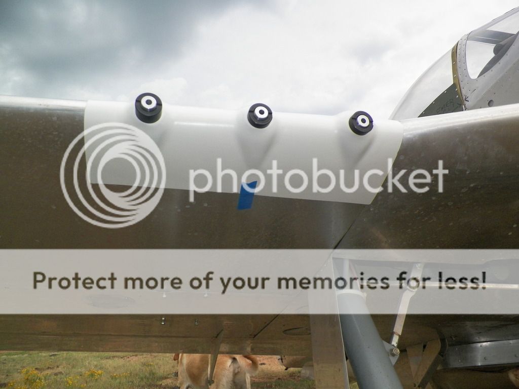

The barrels are being machined now, should be done by late next week. As soon as we get these completed, and the fiberglass blisters made, we will have a good handle on the cost.
This is close to what it will look like...but ours will be much closer to the original in appearance. This installation could have been done far better, and a quality paint shop (GLO-Custom) would really make this look good.
Ours will look more like this:

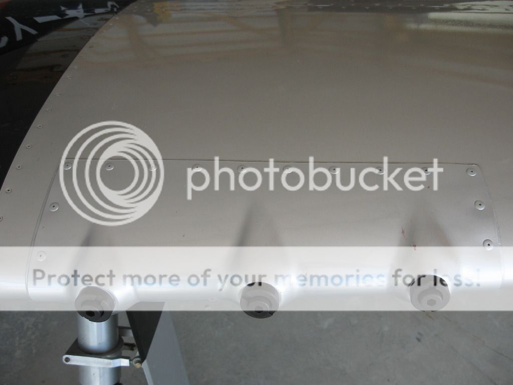

We thought so also. Here's another photo:

Six big multi-edged blisters directly on the leading edge, a hard span-wise trip line near the lowest pressure area of the wing, and a bunch of big dome head pop rivets won't affect performance on a 200 mph airframe? Really?
Will riveting a doubler to the leading edge have any effect on the load path/distribution when the wing tries to flex under load?

Those rivets are not what we would recommend. You can use what ever you like. Real world flight testing shows little or no impact on performance with these installed. Yes, really.
Not certain, but it would appear that the wing root may stall first, leaving aileron control available. These are installed on a number of P-51 replica aircraft.

The planes that are flying with these installed report negligible impact on performance. Perhaps one, maybe two mph speed loss. No affect on stall characteristics, or other flight regimes.
For those of you who are not willing to sacrifice one mph, do not buy these. For those of you who are looking for a WOW factor, this is the ticket.
