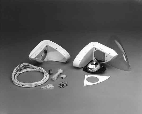

I've been looking for a solution that allows landing/taxi lights in the original Vans wingtips. Any suggestions, links or information is appreciated. The lenses look like this one:

Not what I'm after. The original style wingtip has a flat top. There used to be a kit to modify them to install a cutout for the landing light. I want to use this wingtip because I will be installing a small equipment locker in it.
Looking for this found on RMD Aircraft site, but they are no more. Now Knots 2 U. Called them. They are checking.

Nice people. $500 for two lenses(L & R) and two fiberglass mounting pieces is more than I can afford. Lenses are $132 each. I may end up purchasing lenses and fabricating my own mounting pieces. In any case many thanks to Kevin for the information.
If anyone has an RMD setup like this on the shelf or has a set of old style wing tips with this installed, please PM me. I'm interested in them at an affordable price.

I remember the entire kit was around $250 with lights. Very limited market combined with old, inherited stock makes $500 without lights or wiring or $132 for a single lens, for an experimental, not PMA/TSO, a bit high, IMHO.

Talked to Vans today. They offered two kits for the flat top wingtip until 2013. One by Airtech was the one I remembered. It was about $250. Two possible suppliers checked. One(Chanute) number disconnected. The other, Darb Newton went to voice mail. Any info is appreciated.
