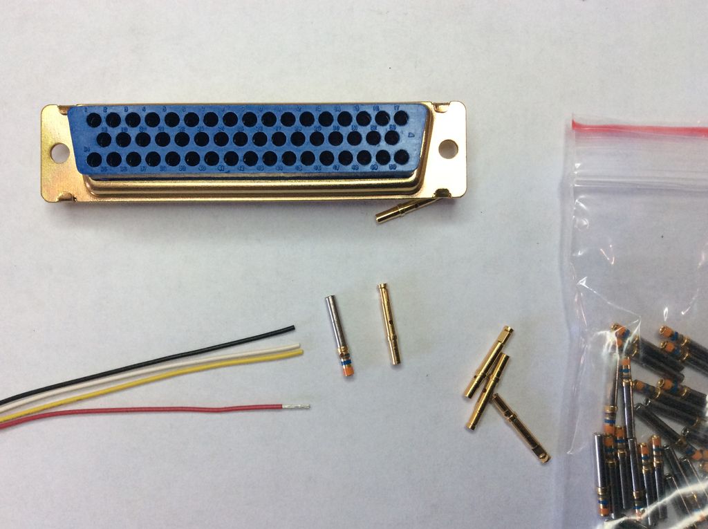

I was about to put the sockets on the wires of the config module but they don't look right to me. Remember I only play an avionics technician on TV.
Here is a photo of the pins (sockets). The config module came with five connectors. I think they are special for the smaller wire size on the little plastic plug. But it looks to me like the witness hole is on the wrong end of the pin? the plain brass colored ones came with the config module. The colored stripe ones came with the backshell kit that came with the 450. If I were to try and flip the pins end for end, the crimp wire size would be too big and the socket would be too small to fit the back of the 450 display. And, the pins would not lock into the connector like they should.
I suspect I will use them, but am I looking at this wrong or something? Why does it seem the witness hole is on the wrong end?

I studied this under my lighted mag lamp and there are TWO witness holes on these five connectors! The wire side hole is really small! What is the hole on the socket end that plugs into the display used for?

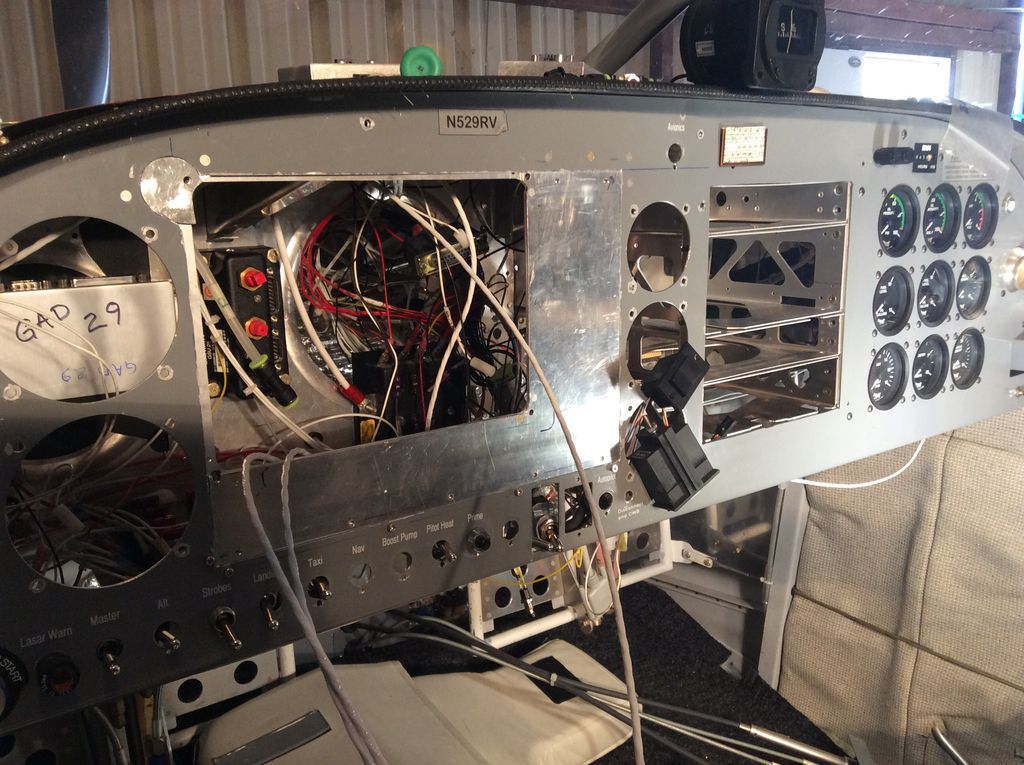

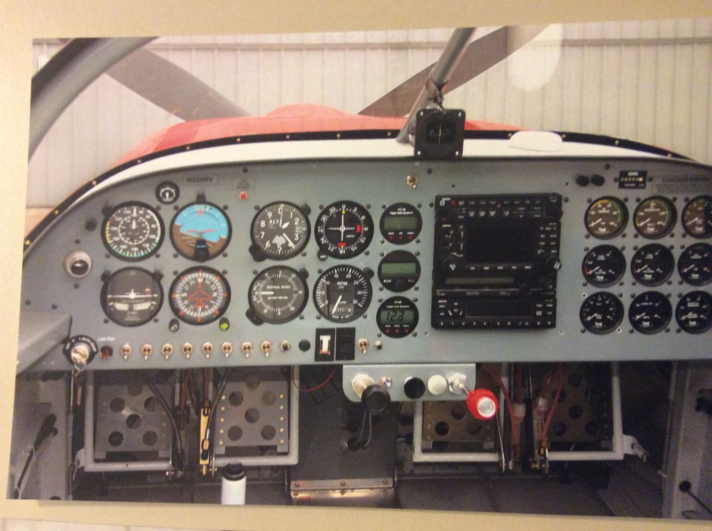

Here is a before and during pictures of my upgrade.

Hello Jim,
As shown on page 1-14 of the G3X Installation Manual (and other places), the 4 wire harness used for the configuration module uses the 336-00022-01 size 20 contact (for use with 28 AWG wire) instead of the 336-00022-02 or 336-00094-00 size contacts used with 22 AWG wire in the other GDU connector pins.
For others reading this, the 336-00022-01 configuration module contacts are the all gold contacts shown in Jim's picture. The wire inserts into the round end with the smaller hole. The other end with the larger hole also has a flat near the end which is where the spring contact lives to make this female pin snug on the male pin in the mating connector.

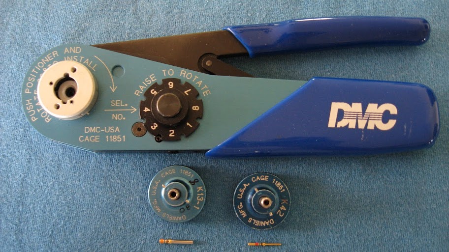

While we are discussing configuration module wiring, let's talk about the pin positioner used in the Daniels AFM8 crimp tool. The installation manual calls out a Positronic 9502-5 positioner, but you may also use the Daniels K13-1 positioner used with all the other standard density pins if you set the "SEL. NO." to 6 on the crimp tool.

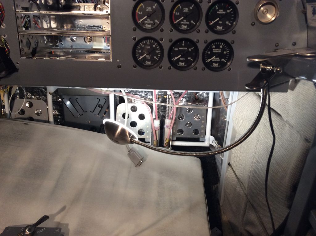

This flex LED clamp on light works so well I had to share. Maybe everybody has already figured this out but I have never used a work light that was this nice. It positions well, has good light output, doesn't get hot, clamps on easily and stays put. Much better than holding a small flashlight in my mouth or getting burned with a standard drop light.
I have four of them around the shop at home, got them at Lowes
