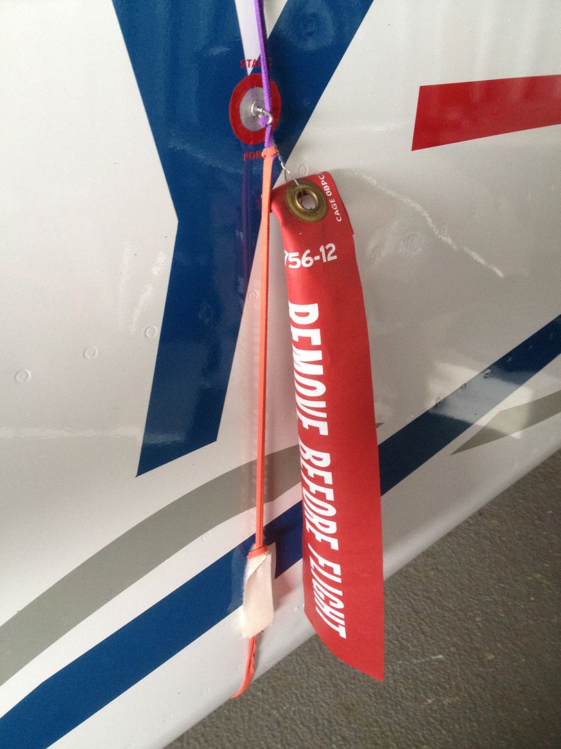

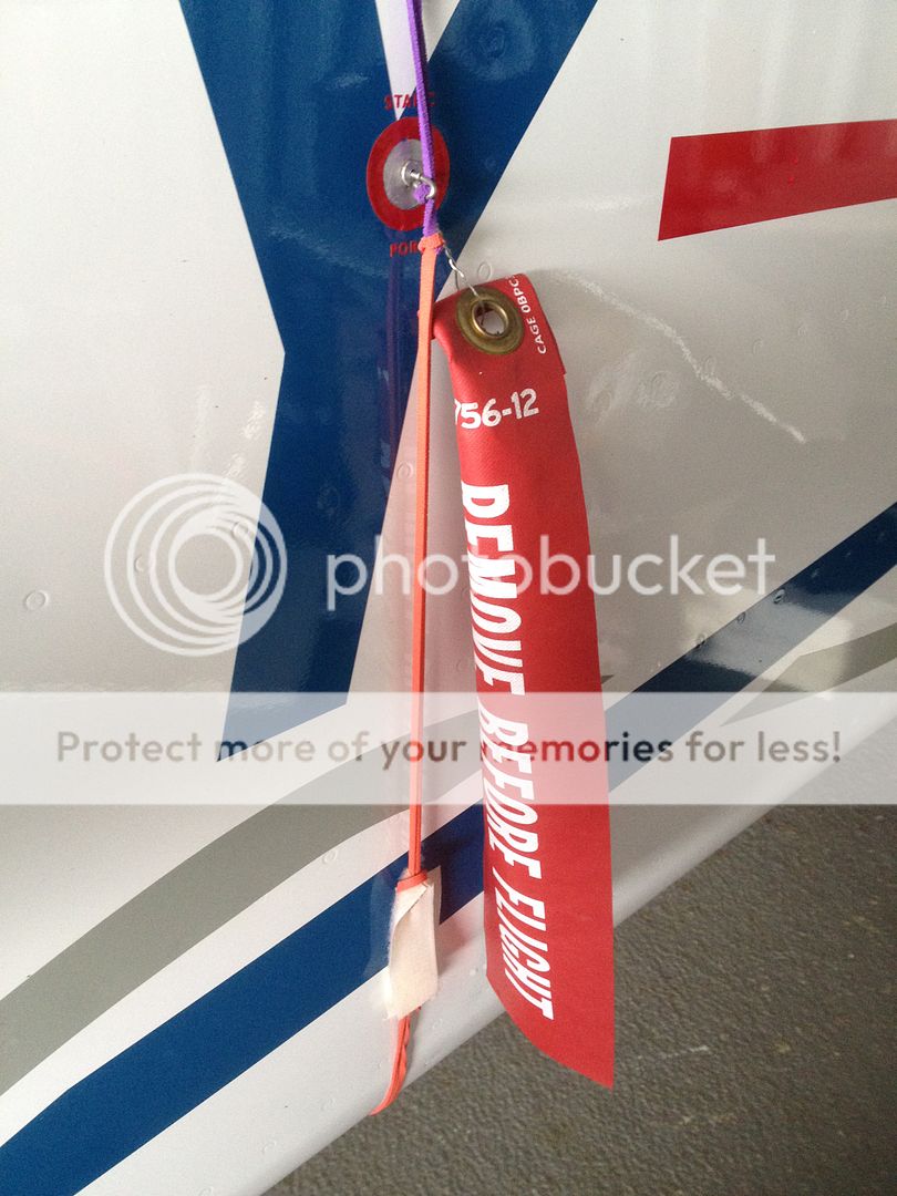

How about this.....?
Bit of a prototype at the moment. Used discarded pop-rivet shanks and heavy duty elastic bands. Will be improved when I find some 1/8" or similar elastic cord.
