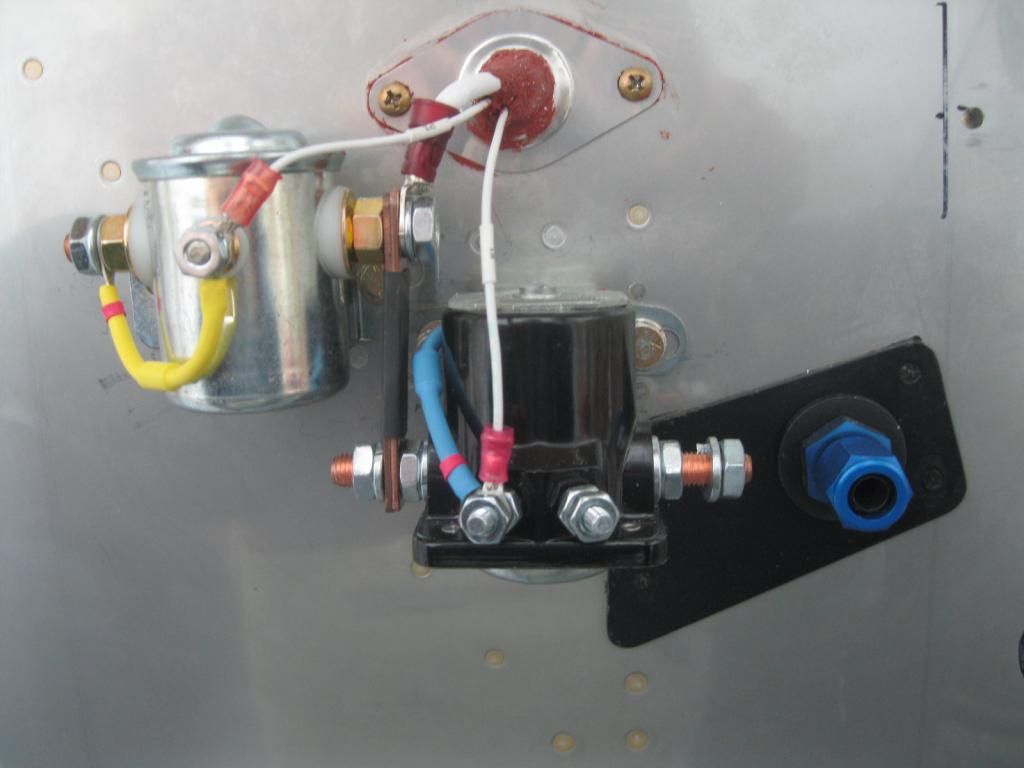

2. On several posts on this forum I see what appears to be some sort of plastic Insulator on the base of the Battery relay. There is never one on the starter relay because the base is the ground. No one at Van's seems to know about this, but I do see them on this forum pictures.
3. Both my contractors are mounted close together. Is there any reason I cannot use a short piece of bent copper bar to connect them. It is less the 2 inches apart and a wire would seem bulky?

On question #3, it's SOP to connect the two contractors with copper strip stock. Van's recommends two strips doubled up to handle that amperage. Use some heat shrink tubing to cover up the center portion.

And Q #2 - It is not a recommendation made by Van's in any plans, and I know of no good reason to isolate the master/battery relay from the airframe. The power for the pull-up coil is provided by the input stud (labeled Bat.), and the ground for the pull-up coil is supplied by activating the master switch.
