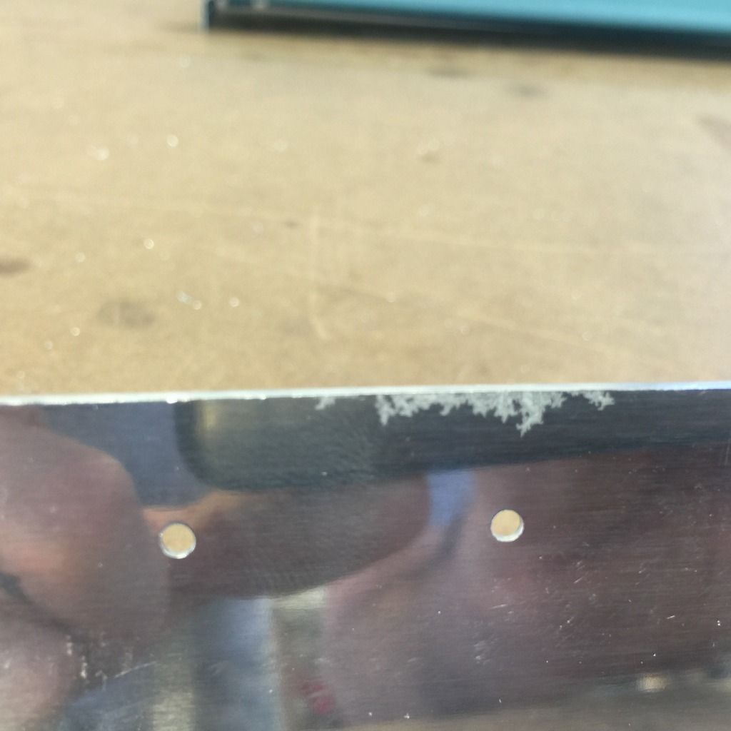

Come down to the southeast. Seen this more times than I'd like - sometimes only a couple months after receiving from Van's:

One very important point that you should clarify is WHERE you have built two airplanes in the past 23 years. I note you are in Flagstaff, AZ. A very arid climate. If indeed you have built in that climate then I can see very easily why you hold to your belief. However, builders who are not so fortunate to be able to have such an arid climate beware. Introduce any moisture between that plastic and the aluminum and you will see very similar evidence as is posted in the pictures above.

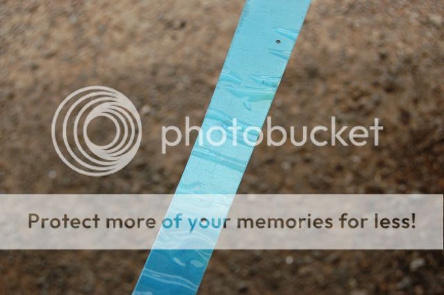

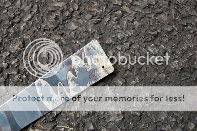

for those who believe plastic is good, let me suggest an experiment. Take a piece of untreated plain steel. ligtly spray water on one side and on the other place a wet towel. Come back in a few days and observe the results. It is my belief that taking steps to retain moisture in contact with anything that can corrode is a bad idea. My kit sat for 10 years in the midwest. Several alclad pieces has corrosion on the edges where it can trap moisture and hold it in contact. Corrossion is due to moisture wicking in between the plastic and aluminum and not easily dissipating. The open edge allows a path in.

Opinions vary, but having been RVing since 1987, my opinion of the plastic film is that it comes from Satan and will lead to the downfall of mankind.
Leave that stuff on a part, store it in the average hot, humid mid-western garage and it will likely look much worse than Jon's photo. And if you're really lucky, it will peel off in tiny strips too.

Which is why in Paragraph 5.12 in Section 5 of the construction manual it says....
The adhesive on the vinyl strengthens with age, so if the coating is left on for more than a few weeks, it may become very difficult to
remove. Corrosion has been found under the vinyl in some instances. If vinyl covered parts must be stored for long periods remove
the vinyl first.

was incredibly difficult to remove on my early rv8. I tried everything to no avail, until someone suggested... paint remover. It is messy, a royal PITA, but works. Have had no issues getting the blue stuff off, even after all of these years in the Pacific NW.

And I've seen deposits like that on my alclad before; it's like bathroom scale. Very annoying to remove, but the aluminum underneath is fine. Real corrosion does not generally look like a feathery crystalline deposit; it looks bubbly, sometimes like worm tracks. Not to say don't worry about it; when it gets as bad as the picture Vlad shared, it can lead to real underlying corrosion.
