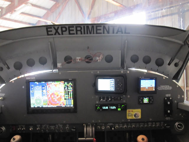

In my VFR ship, I realized that one 10" SkyView was more than enough screen space for me.
The small display on the right is a Dynon PocketPanel.
However, to answer your question, I would put cardboard displays on the panel blank and sit in front of it for some time. Only then will you know what you like.
