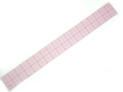

I think a flexible C-Thru ruler is easier. Typical one here is 18 inches and marked in 1/8 ths.
Simply use the red lines as a guide to keep the line you are marking parallel to the edge. Then use the same ruler to mark the rivet locations at the required spacing.
$8 or so well spent.
