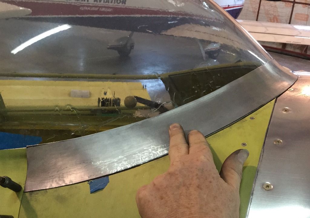

The one easy exception is an all metal faring around the base of the windshield.
Easy to make with a home made large edge forming tool.
Shown in an old RVator article -
https://picasaweb.google.com/1054628...OrUkIa2g-KjJA#
Mel is right. This piece is simple in comparison to cowl/tips but it still takes some skill. It took me two work sessions to make mine so it may have been faster that fiberglass. A number of us have done it.

http://i1373.photobucket.com/albums/...ps6xmn48dm.jpg
Don't know where "Mel" comes into it.
But I made my windscreen fairing in two sections. The first one took an afternoon, the second one took an hour.
Making a glass one would have had many more steps and much more final smoothing.
The RVator instructions were easy to follow and just needed some careful cardboard template cutting and angle measurement.
The resulting part has more of a sharp corner than the pictures in the previous post, which probably was formed with a shrinker or by hammering.
