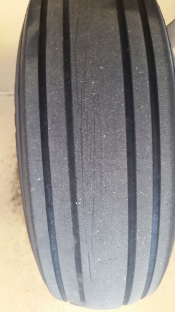

I put these on and see they are showing these cracks. Is that normal? Both mains have the same small cracks running along the centers. They are about a year old and I ordered them from Spruce.

Looks more like "scuffs" then cracks.
Usually you see that happen on rough runways.
You have a lot of tread left so it doesnt appear to be an issue.
Just make sure none of the "scuffs" are not "cuts".
If a cut goes to deep then you have a problem....

Maybe my anti skid is INOP. Maybe it was never installed. I'll have to look in the mx logs.

When it happened to me, tire pressure to low. Desser says 40 PSI plus and you won't get these cuts. I did that and I haven't had any since. I know the PSI is higher than Van's says but if you don't get a shimmy more is better. I run 45 in my RV6A all the time. It works for me.

Unlike the Patriots, I am an over-inflater. I run 45 psi. I'm told it builds character too.
