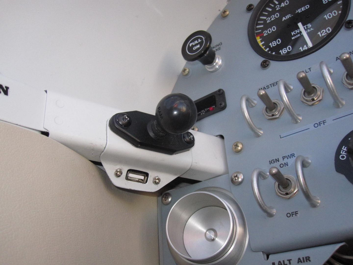

Here is what I did: I mounted a RAM BALL Adapter on each side of the cockpit. Cut the baseplate some and painted black to streamline it with the cockpit rail. On the right side I already had USB power on the panel, on the left I installed another plug below the mount - see pic.
This worked out best for me, I can mount different pads there by simply changing the holder for the pad. I once had a foldable tray below the throttle in the center however the present location is far better.

Herman - very nicely done!
